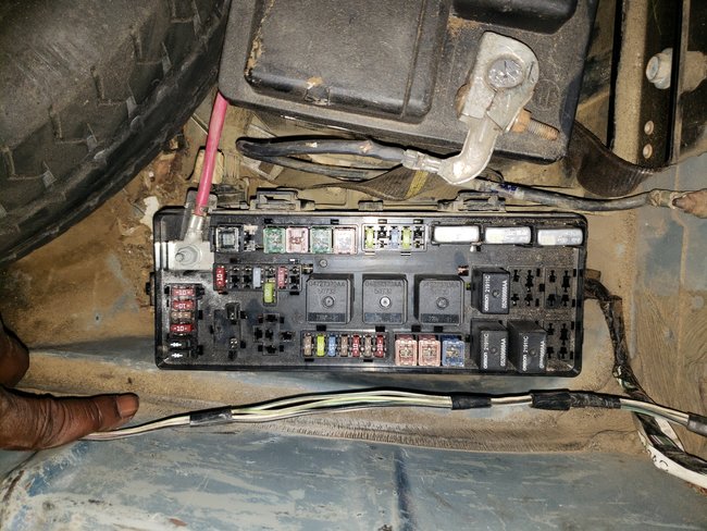

Hi, :)
I already checked the fuse box, replaced the hazard button on the dash, and i changed a relay (that is related to the flasher lights) inside the instrument panel. Still does not work! I am wondering if anyone is familiar with my problem.
Thank you for your time.

This can be the hazard switch itself which ground the circuit at the front control module. Here is a wiring diagrams to help you see how the system works.
Also check the fuses.
I would try grounding the hazard switch wires to see if the hazards start working

I just found out how to fix this, in the trunk fuse box is the big silver 25 amp fuse. In the upper right hand side. Its either #11 12 or 13. I don't know because I switched all of the at once.
