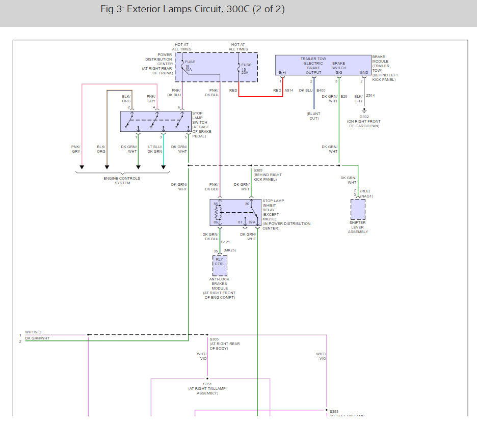

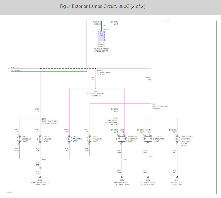

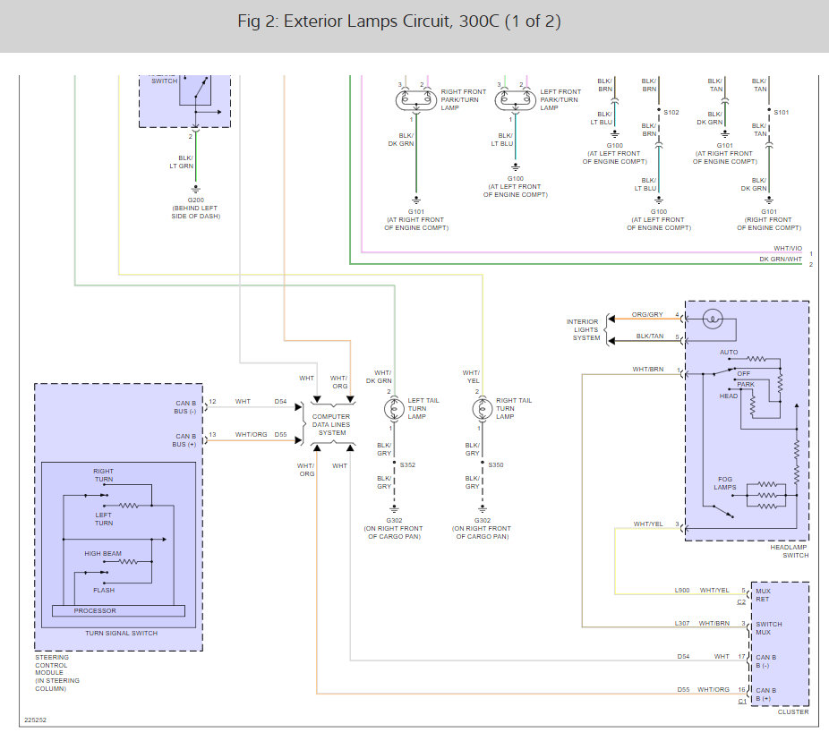

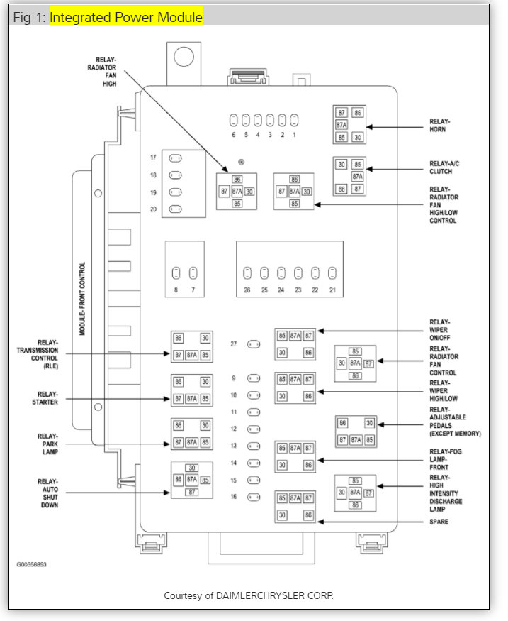

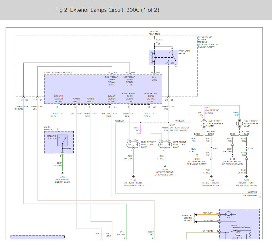

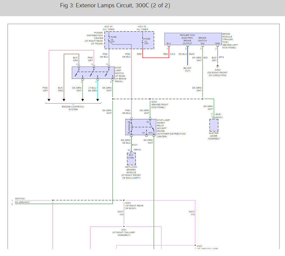

This can be the hazard switch itself which ground the circuit at the front control module. Here is a wiring diagrams to help you see how the system works.
Also check the fuses.
I would try grounding the hazard switch wires to see if the hazards start working

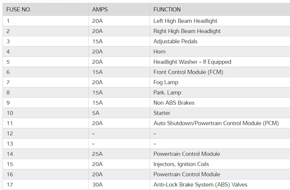

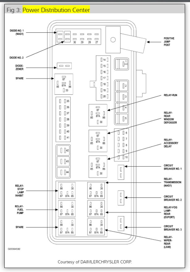

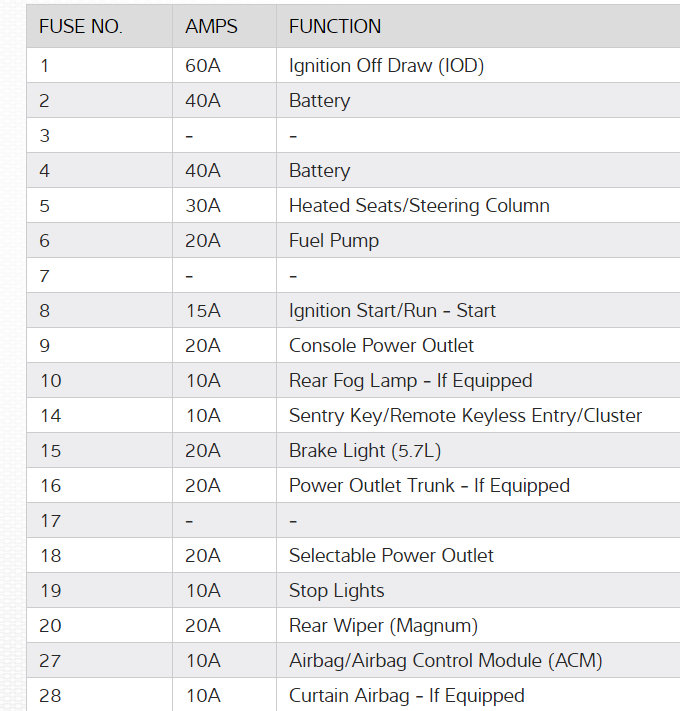

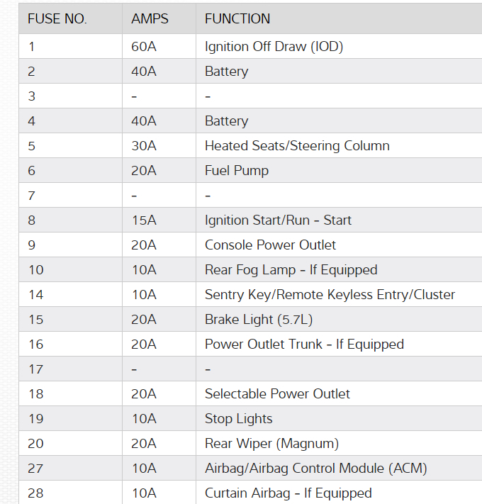

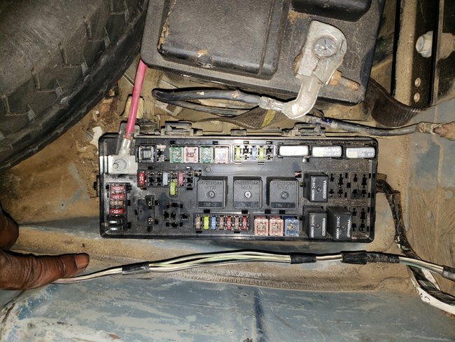

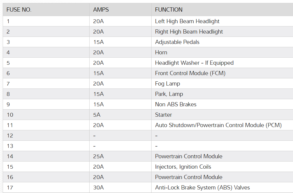

I just found out how to fix this, in the trunk fuse box is the big silver 25 amp fuse. In the upper right hand side. Its either #11 12 or 13. I don't know because I switched all of the at once.
