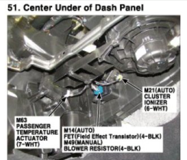

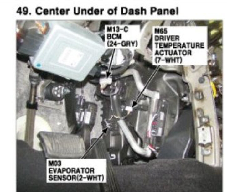

A/C compressor is turning on properly and the condenser fan is turning on as well. The system is fully charged, but I am getting no cold air inside the vehicle.

Also, I'm not sure if you have dual climate control or not. However, there are air temperature actuators (blend air door actuators) that are responsible for the air temperature entering the vehicle. I one or both (if you have dual climate control) are not working, that could be the issue.
I attached two pics below showing their locations. See if when you go from heat to AC if you notice them move, make noise, or hear the airflow direction change in the ductwork.
Additionally, take a look through this link. The link is for replacing one. It is designed in general to provide a general overview. But it also explains how it works. I thought it may be of interest to you.
