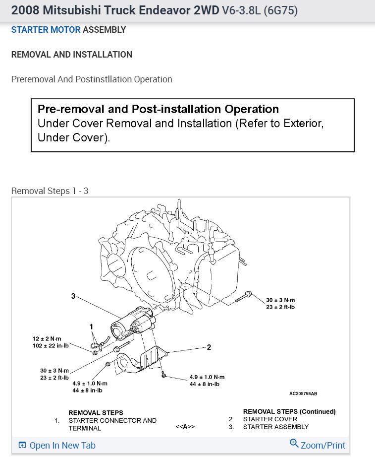

Most of the time the problem will be the starter because it will have a bad spot that will get worse with time, but to be sure we can use a test light on the trigger wire when the engine is not cranking over.
This guide will help, and I have included how to swap out the starter motor in the images below:
Check out the images (below). Please let us know what you find.
