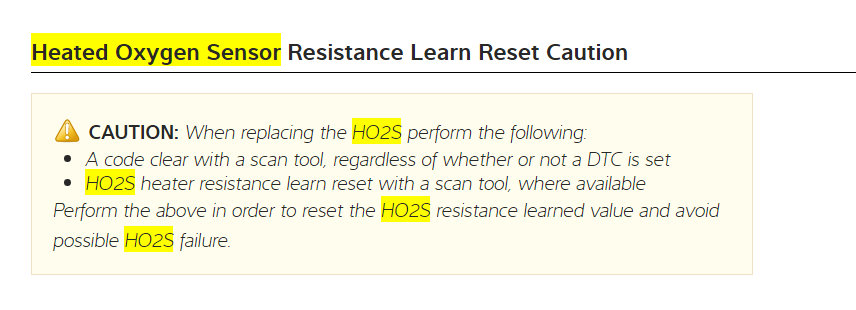

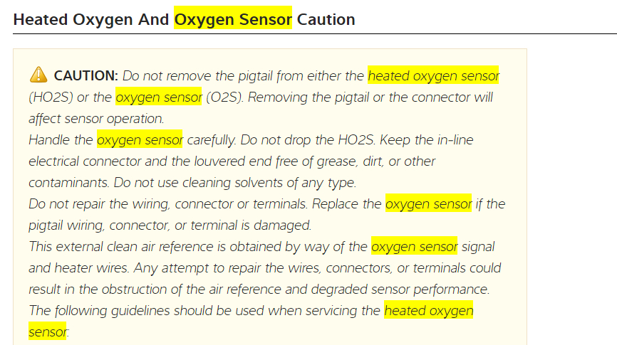

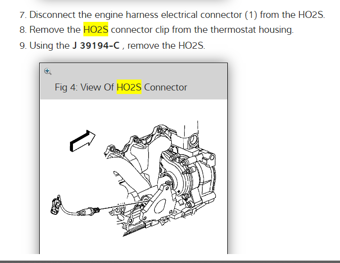

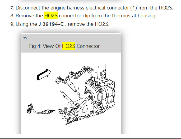

Have to change a o2 senor up stream
167 MILES • 2.2L
BRANDON BURDICK
Don't know where it is located on the car listed above; lS 2.2l.
Aug 23, 2019 at 5:43 PM
SCGRANTURISMO
  • 4,897 POSTS

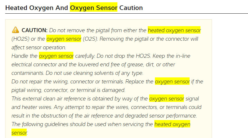

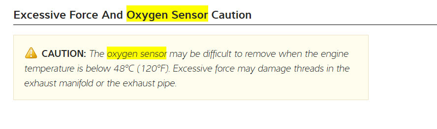

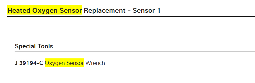

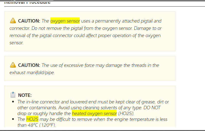

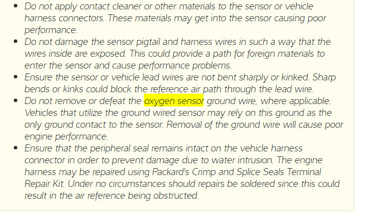

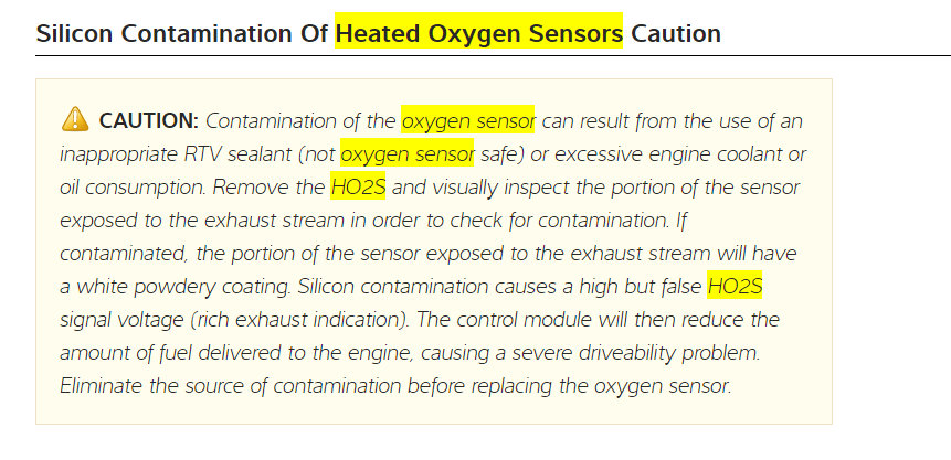

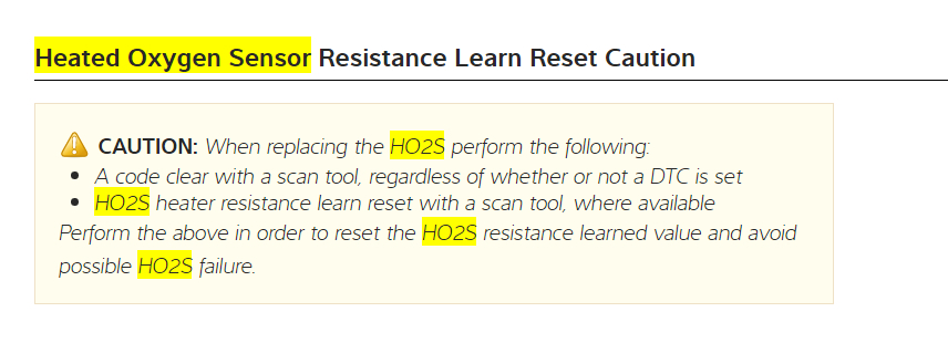

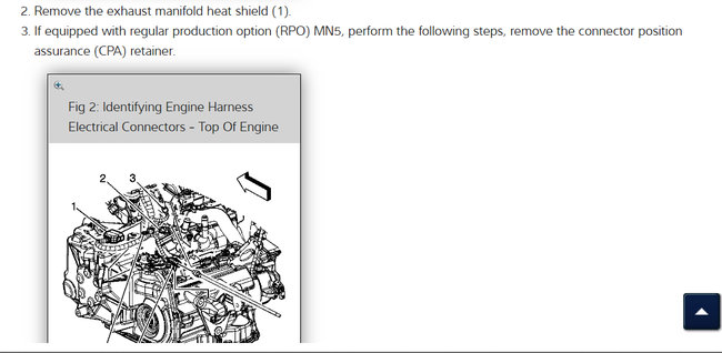

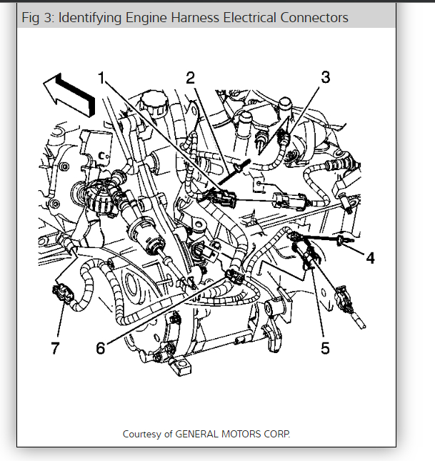

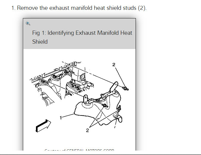

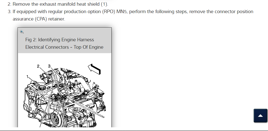

I have included in the diagrams down below the factory guide for the removal of the HO2S1 sensor from your vehicle. The installation is the reverse of the removal procedure. Please go through this guide and get back to us with how everything turns out.
