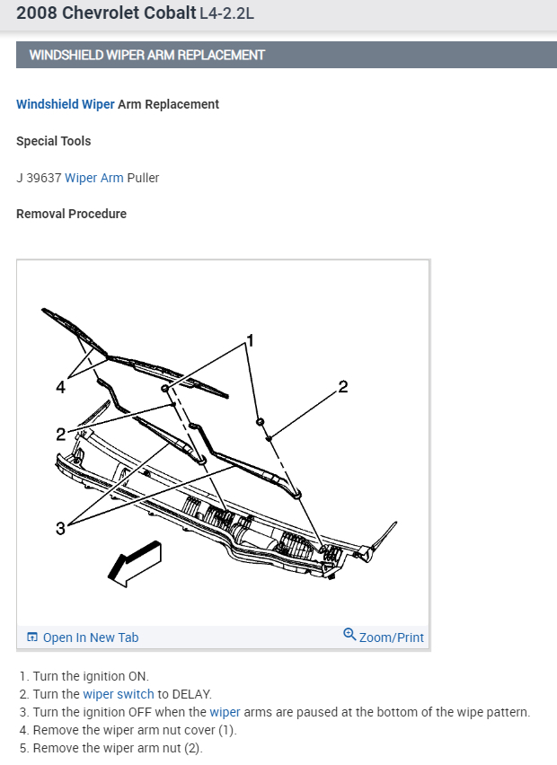

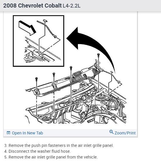

How to remove the lower plastic portion of the front windshield?
134,000 MILES • 2.2L • 4 CYL • 2WD • AUTOMATIC
AZDANNO04
  • 378 POSTS

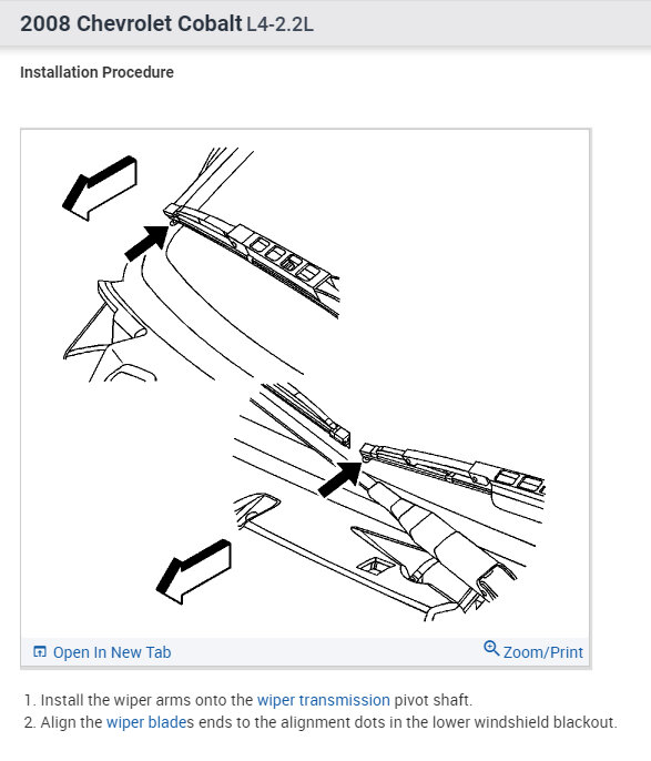

Just need to know how to take off the windshield wipers to get the old plastic portion off I have the replacement.
Nov 29, 2022 at 5:30 AM
SQM
  • 6,383 POSTS

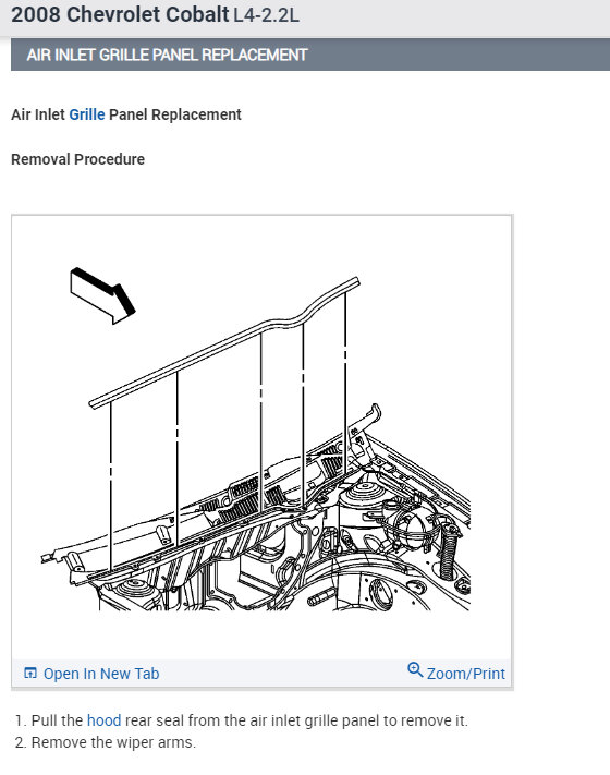

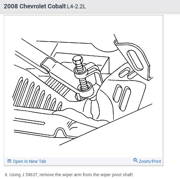

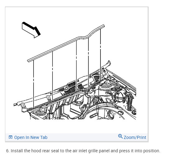

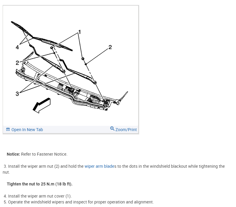

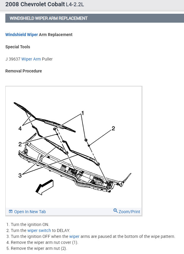

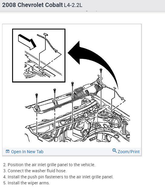

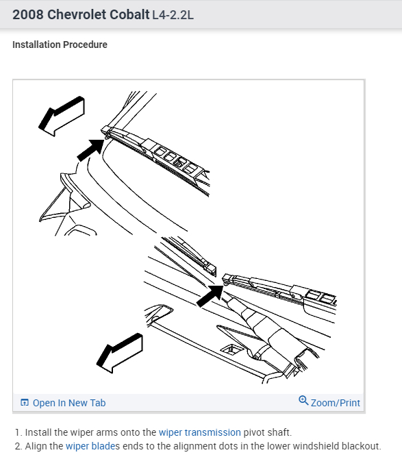

The wiper arms are pressed on the shaft and will need to be pulled off using a special tool.

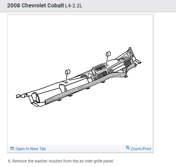

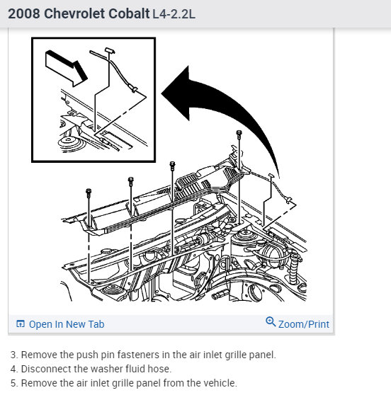

After the arms are removed, the plastic piece (cowl) can be removed by taking off the fasteners.
I have attached the wiper arm and the cowl removal and installation procedures below.
Let me know of any questions.
