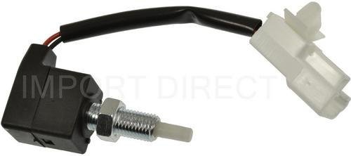

When I push the clutch in the car does not start.
Jun 26, 2018 at 12:41 PM
DANNY L
  • 5,648 POSTS
Hello, I'm Danny-
It sounds like you are having a problem with the Clutch Starter Safety Switch. It is mounted on the clutch pedal assembly and acts as an Anti-start feature if clutch not depressed for starting. Here is a similar picture of the part.
