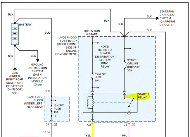

sometimes starts after turning key several times found if i turn to accessory and waiting for dash lights it starts if battery not drained. battery drains after 24 hours of not running.
already replaced ignition switch still having same problem firestone said battery and alternator good. Castriota chevy was going to replace ignition switch even after i had then decided not to and said they thought it could be 1 or more of 5 modules.

I would think they could have narrowed it down a bit for you. There are a couple of the modules you mentioned that wouldn't cause it. I know the PCM is tied into it. I also know the CAN system is tied into it.
By any chance, does their receipt have the diagnostic trouble codes they found? Also, you mentioned that "The car battery drains if I do not start it during that time." What time are you referring to?
When the lights turn back on, do they just start working normally or does it slowly go from dim to bright?

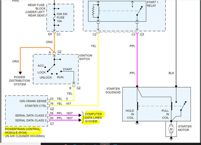

I attached the wiring schematic below for the starting system. I highlighted a few things. First, the starter relay. Do me a favor. Remove it and inspect the connections in the box for corrosion or damage. Next, if you look at pic 2, I highlighted the wiring for the computer data lines. That is part of the CAN system. CAN stands for controller area network. If they scanned the CAN, it should be a little more specific than just one of five modules. That's why I asked if the codes are listed on the receipt.

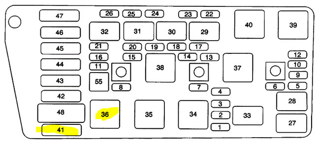

One other thing of interest. The starter relay is powered off a circuit breaker and not a traditional fuse. Something could be causing issues there as well.
Let me know if they included the codes that were found. Also, let me know if you are able to have the can-bus scanned.
See pics below. Note: the wiring schematic was one page long. I had to cut it in half to make it readable for you. Pic 3 shows the starter relay and the circuit breaker I mentioned. These are in the under-hood fuse box.

the time i was referring to is when i jump the car and let it charge battery if i turn it off and restart it works for a couple hours but if i do not keep restarting and charge battery it drains empty in about 6 hours maybe less time as far as codes i do not see any on the diagnostic system check theft deterrent it states there was a lack of communication which may be due to a partial malfunction of the class 2serial data circuit odue to total malfunction. the presence of DTCs U1161.U1162,U1163 or U1170 indicate 1 or more of the door modules is not communicating on the sbi circuits the presence of DTCs which begin with U indicate some other module is not communicating.
