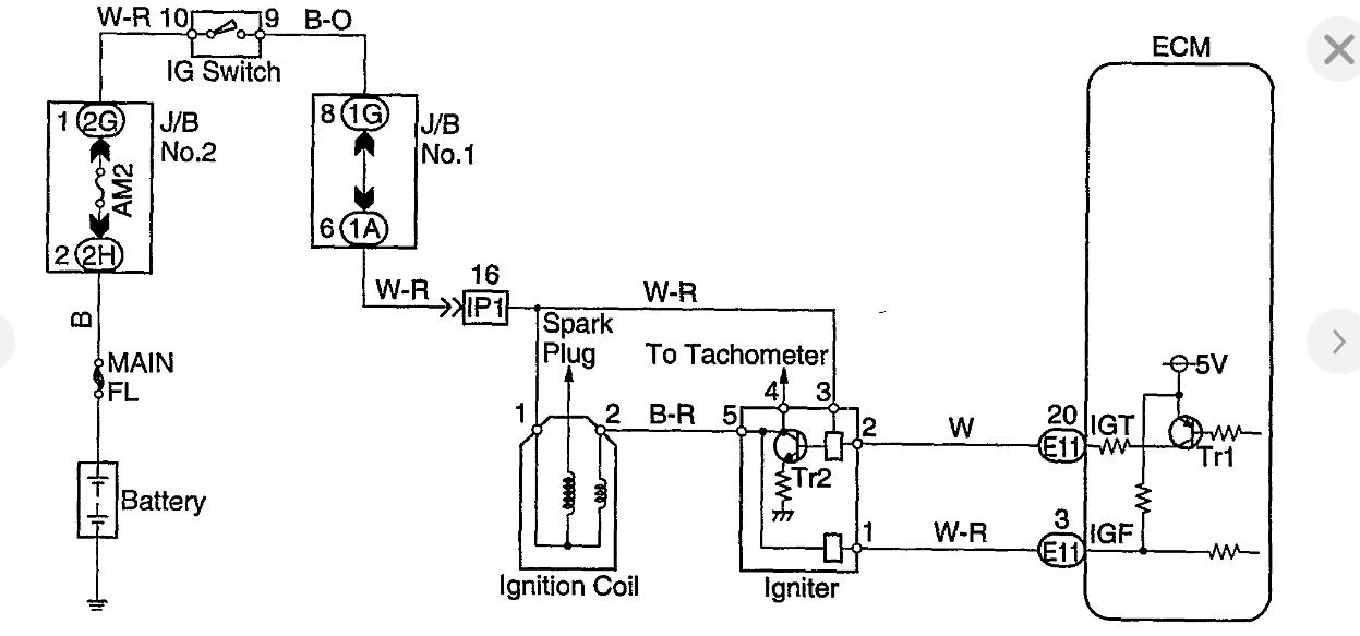

You have not found the reason the ECM has failed, they will continue to fail until the cause is found.
The possible failure is wiring. If the wiring is damaged or there is a short, it will burn out the ECM.
The wiring will have to be traced out to see if there is any damage.

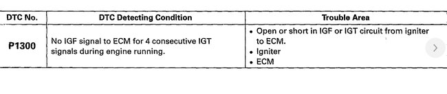

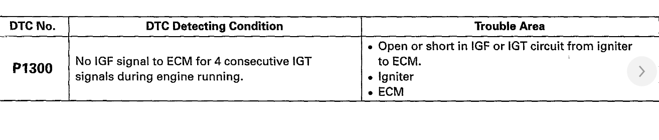

DTC P1300 Igniter Circuit Malfunction
CIRCUIT DESCRIPTION
The ECM determines the ignition timing, turns on Tr1 at a predetermined angle (°CA) before the desired ignition timing and outputs an ignition signal (IGT) "1" to the igniter.
Since the width of the IGT signal is constant, the dwell angle control circuit in the igniter determines the time the control circuit starts primary current flow to the ignition coil based on the engine rpm and ignition timing one revolution ago, that is, the time the Tr2 turns on.
When it reaches the ignition timing, the ECM turns Tr1 off and outputs the IGT signal "0".
This turns Tr2 off, interrupting the primary current flow and generating a high voltage in the secondary coil which causes the spark plug to spark. Also, by the counter electromotive force generated when the primary current is interrupted, the igniter sends an ignition confirmation signal (IGF) to the ECM.
NOTE: The ECM stops fuel injection as a fail safe function when the IGF signal is not input to the ECM.

Okay, did you verify voltages at the power points in the diagram? This is not necessarily a component failure, it is more of a voltage supply issue.
