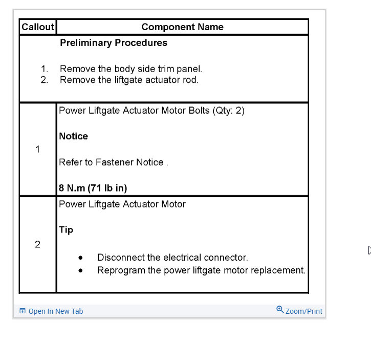

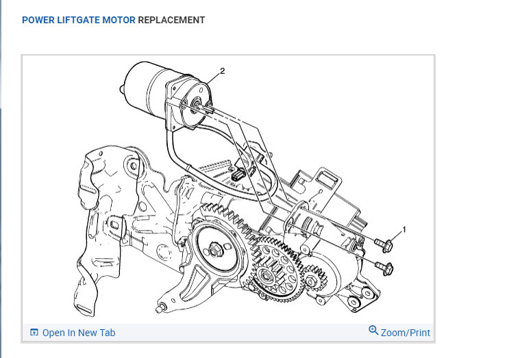

Most likely this is the motor or gearing (shown in picture) that is binding. This motor works on resistance and basically when it sees resistance it reverses course because it thinks somebody is then trying to close it.
The popping noise that you are hearing is the actual binding.
The only way to find this is remove the interior panels and sit in the back and operate the lift-gate and see what is actually going on.
Let me know what you need further then this and I will be happy to assist.
