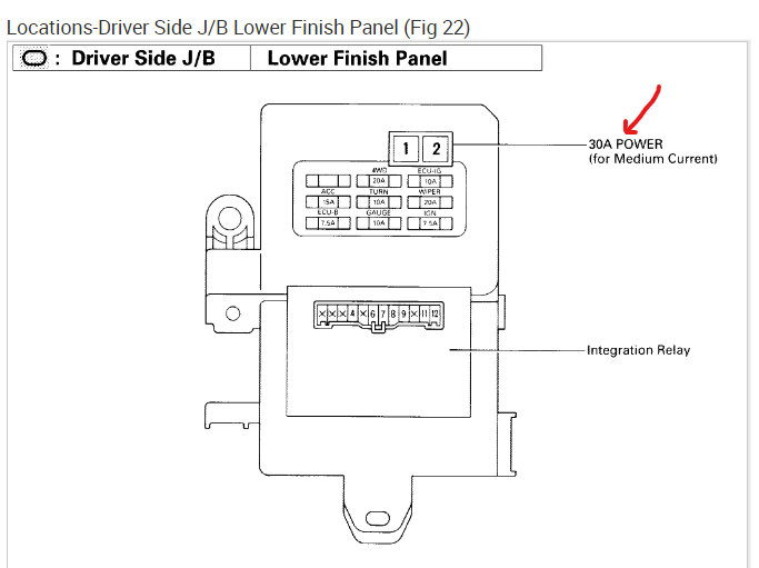

It could be the "power" fuse 30 amp is not getting power or is bad. Here is a guide to help check the fuse condition and for power please test with the key on:

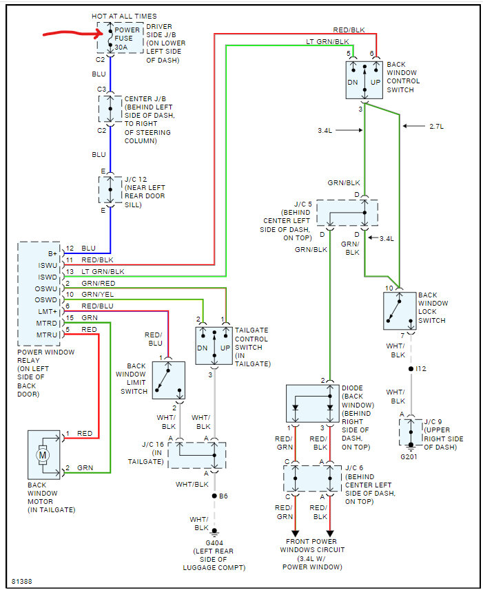

Here is the fuse location and the rear hatch window and the wiring diagrams so you can see how the system works. Check out the images (below). Please let us know what happens.

The 30-amp fuse also provides power to every other low amperage system in the car. Locking doors, other windows, etc. If that fuse was out, I would have a lot more problems. The diagram was very nice though so thanks for that.

Yep, we need to start somewhere, and you would be surprised how many people need to double check fuses. Do you have power at the blue wire at the relay? If so, I would check the ground at the limit switch, blk/wht wire.

The rear window limit switch controls the ground circuit.
