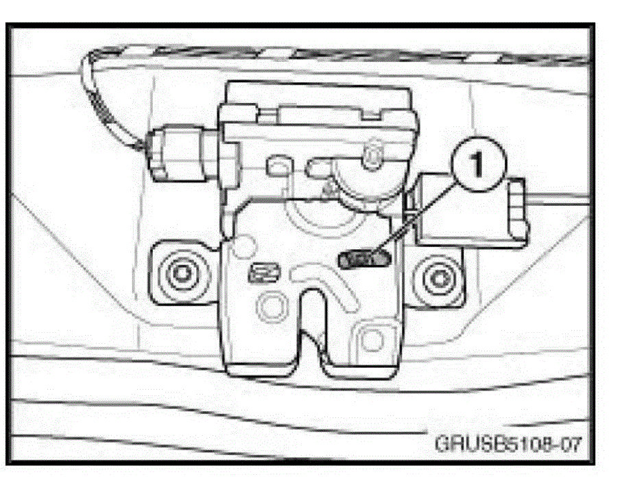

1. Remove the rear latch cover trim per repair instruction RA 51 46 050.
2. [NEW] Early production cars have a manual release tether located under the rear seat bottom cushion, which has been eliminated from later production cars.
a. If the car does not have the manual release Bowden cable, operate the manual release lever of the latch, and then remove any debris which may be lodged in the latch.
b. If the car does have the manual release Bowden cable, determine whether it is still connected to the release lever on the latch. If the cable is NOT connected to the latch, the retaining lug is likely lodged in the latch. Continue with the following procedure.
pic 1
3. Remove the lodged black plastic ball from the area around the release lever (1).
4. [NEW] Replace the emergency release Bowden cable per repair instruction RA 51 24 065.
NOTE:
If the vehicle was not equipped with a release cable from production, it should not be retrofitted to that car.
5. Ensure proper operation and reassemble the vehicle.

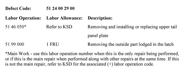

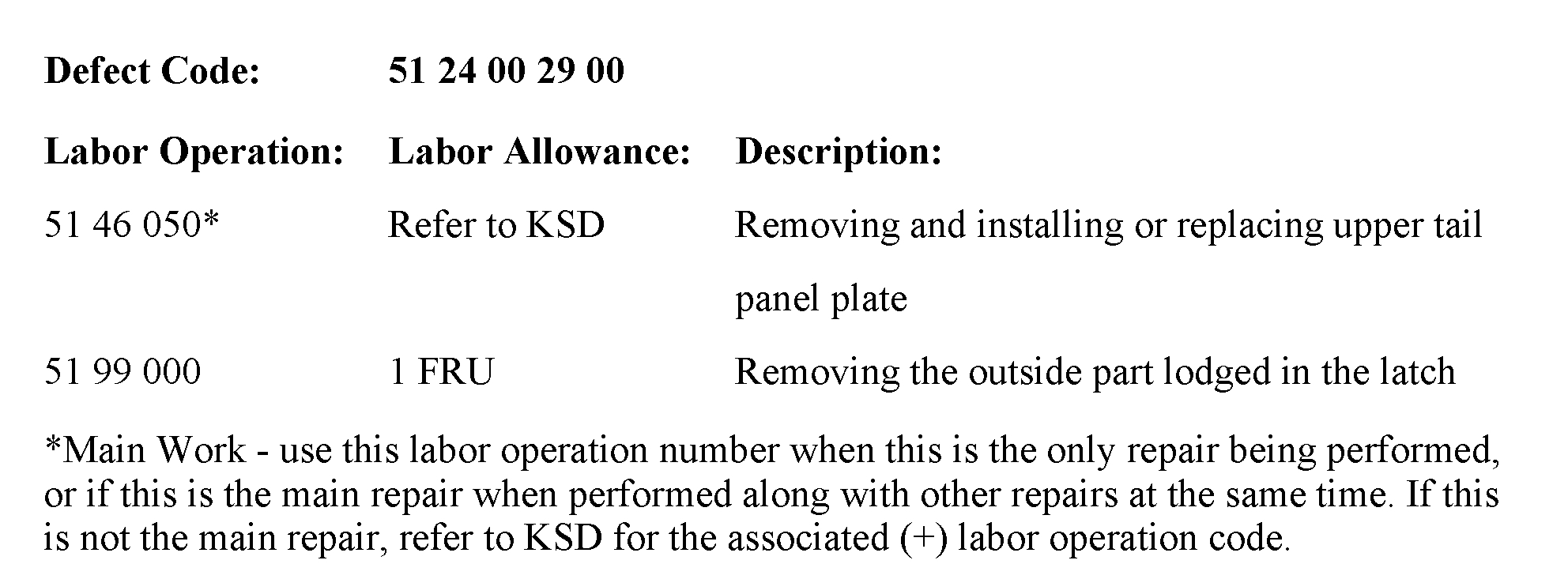

PARTS INFORMATION
pic 3
WARRANTY INFORMATION
Covered under the terms of the MINI New Vehicle Limited Warranty.

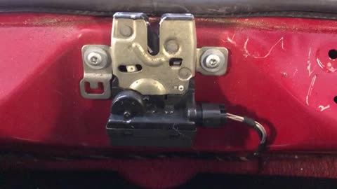

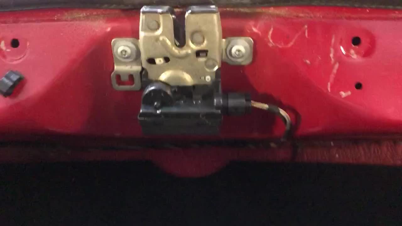

No mine latches but keeps unlatching randomly, sometimes it keeps doing it sometimes doesn't.

No it still did it even with the piece away from the latch.

Took off the above tag latch trim and disconnected the button and it stopped doing it, still opens with remote.
Mar 23, 2020 at 1:19 PM
  • 110,194 POSTS
Something is shorted to power. Chances are the switch is bad.
