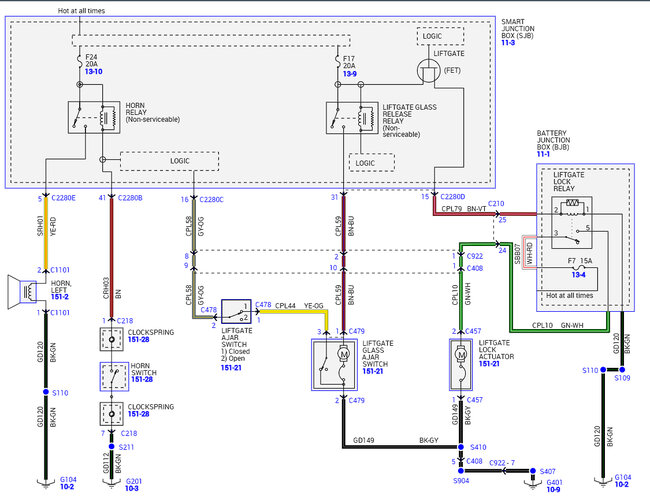

Rear hatch and glass will not open. I do not hear them unlocking. I have changed the hatch. I have power at the lock plug. I think I have got the wrong ground hooked up. Could you tell me which color wires should be hooked up?

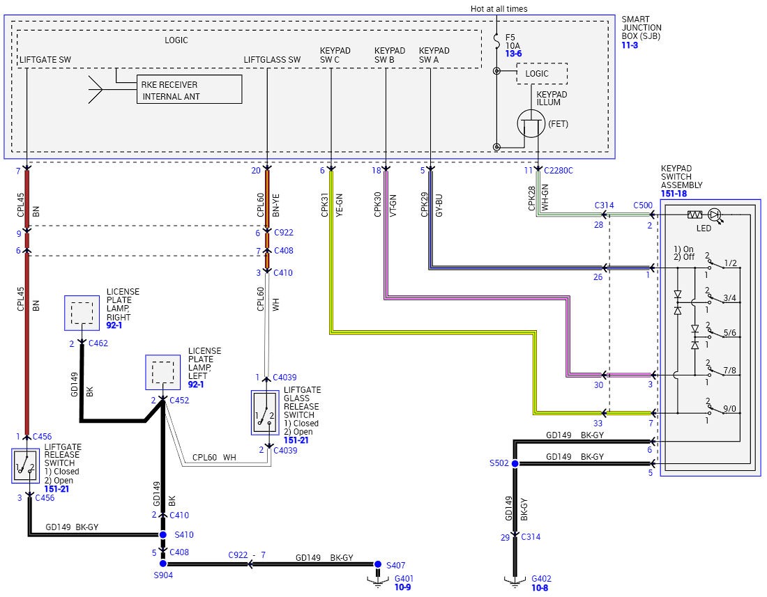

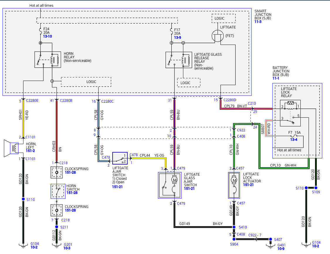

Here are the diagrams for the liftgate and glass. If you need any more assistance, please let us know. Check out the images (below). Let us know if you need anything else.
