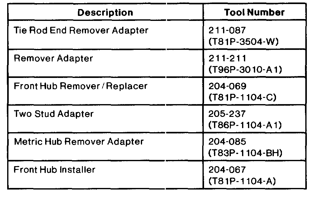

Special Tools

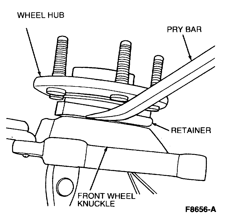

2. Remove front axle wheel hub retainer.

5. Using Tie Rod End Remover 211-001 or equivalent and Tie Rod End Remover Adapter 211-087, remove tie rod end from front wheel knuckle.

9. Remove and discard lower ball joint nut. Using Remover Adapter 211-211 (T96P-3010-A1), separate lower ball joint from front suspension lower arm.
10. Using Rotunda Spring Compressor 014-00781 or equivalent, compress front coil spring until lower ball joint clears front suspension lower arm.

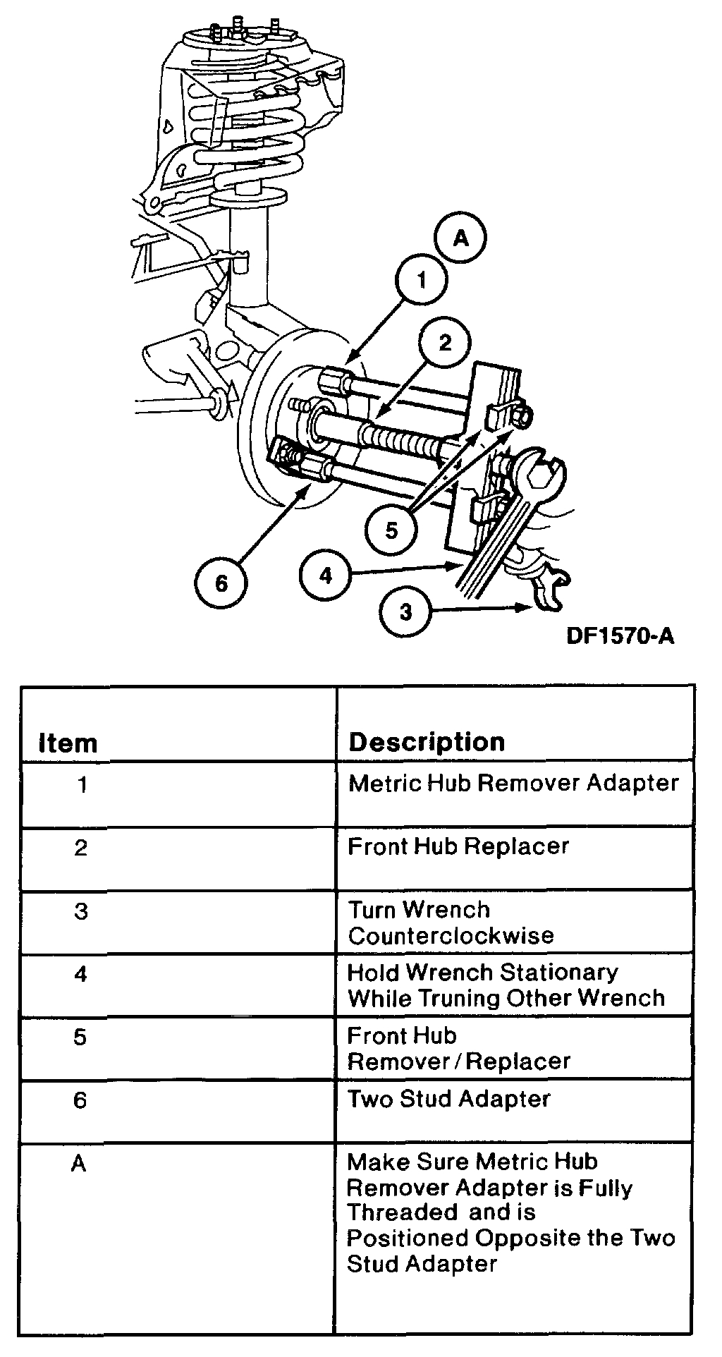

11. Using Front Hub Remover/Replacer 204-069, Two Stud Adapter 205-237, Metric Hub Remover Adapter 204-085 and Front Hub Installer 204-067, press front wheel driveshaft joint from wheel hub. Wire front wheel driveshaft joint to body to maintain a level position.

13. NOTE: Wheel hub is not pressed into front wheel knuckle. Do not use slide hammer to remove a stuck wheel hub. Do not strike back of inner bearing race. Use of these methods will damage bearing internal parts.
NOTE: If bearing carrier is corroded to front wheel knuckle, apply Rust Penetrant and Inhibitor D7AZ-19A501-AA or equivalent meeting Ford specification ESR-M99C56-A to the inboard and outboard wheel hub/knuckle mating surface and allow to soak.
Remove wheel hub from front wheel knuckle.

4. Push front wheel driveshaft joint into wheel hub. Hand start front wheel hub retainer.

10. Install front axle wheel hub retainer. Tighten to 230 - 275 Nm (170 - 203 ft. lbs.).
