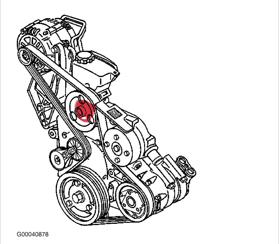

Has to do with the serpentine belt?
200,000 MILES • 3.4L • 6 CYL • AUTOMATIC
BETHENY93
I just need to know the precise name of a certain part. Please and thank you in advance! It’s the part that’s marked red in the photo.
Feb 10, 2025 at 10:44 AM
STEVE W.
  • 15,399 POSTS
That is the pulley for the power steering pump behind it. There is a special puller and installer used to do those steps; you can usually get it as a loaner tool from the parts store. There are a few variations of them, plastic, steel and aluminum. They are interchangeable on that vehicle.
