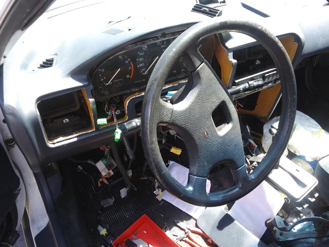

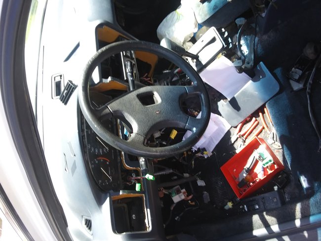

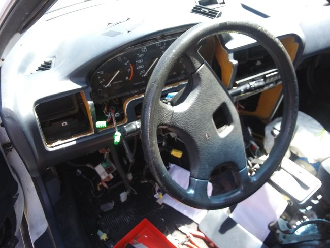

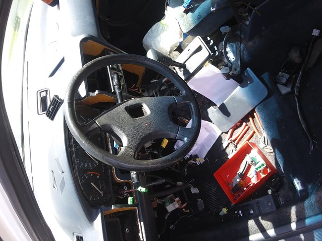

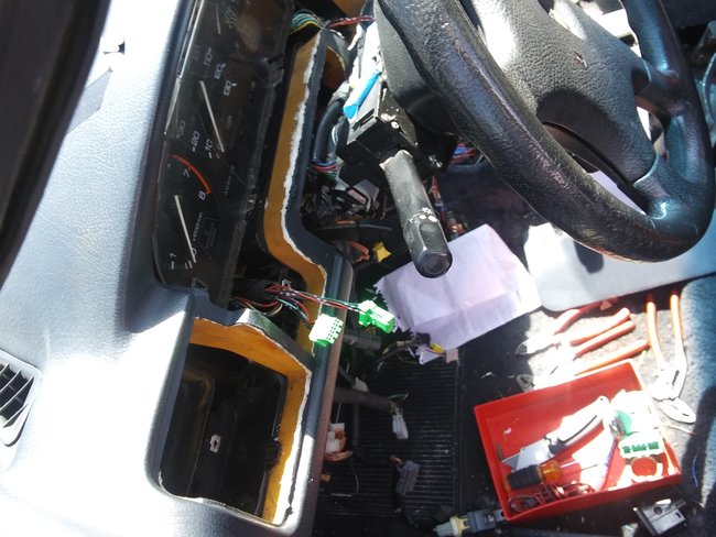

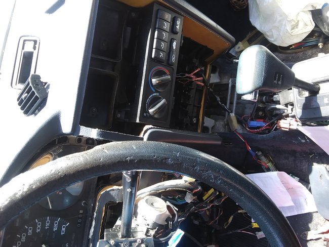

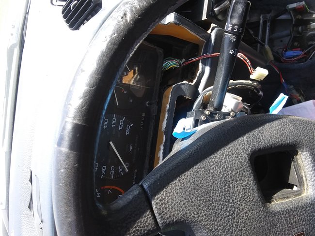

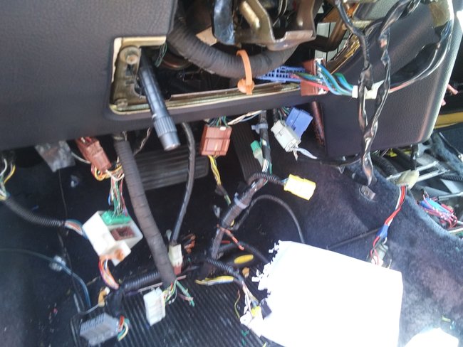

I got the harness that goes under the dash from another Honda. I didn't get the complete harness so it is cut in a couple places. Now I'm trying connect everything including the dashboard and gauge cluster and all pretty much. Is there a step by step instruction to help me? I am worried I'm not going to be able to get it all right.

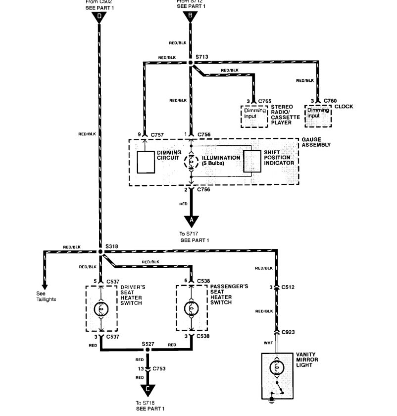

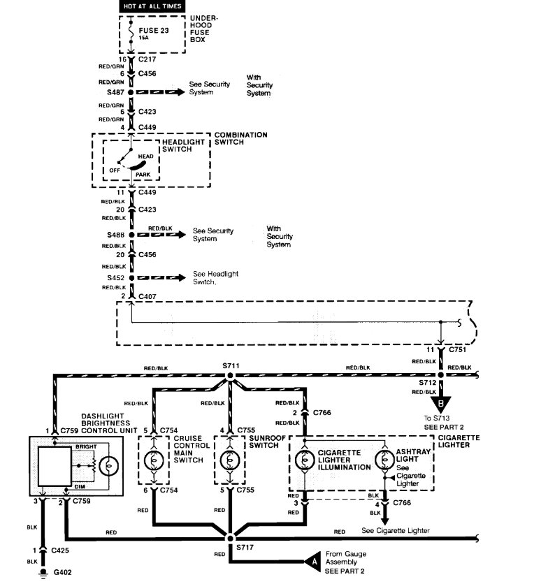

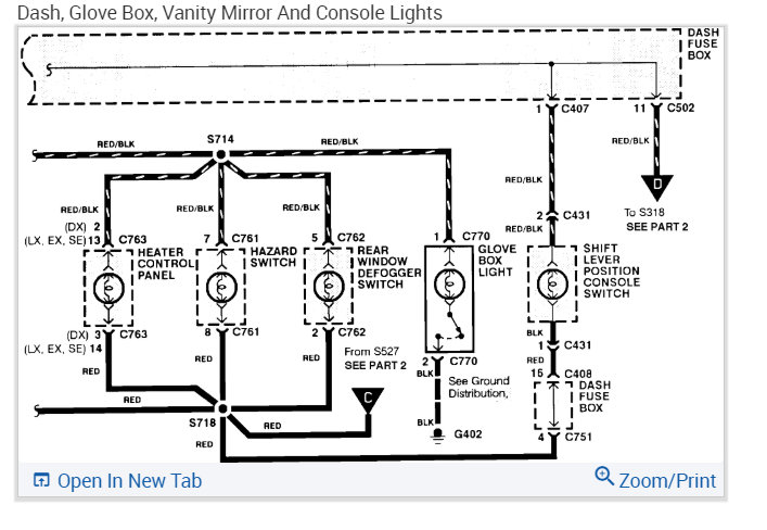

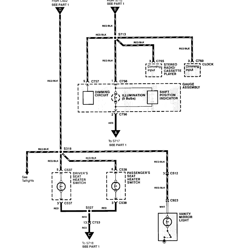

Yep, I can get you wiring diagrams. Below are the ones for the cluster to get you started. let me know if you need more. Here as how you test the connections:
