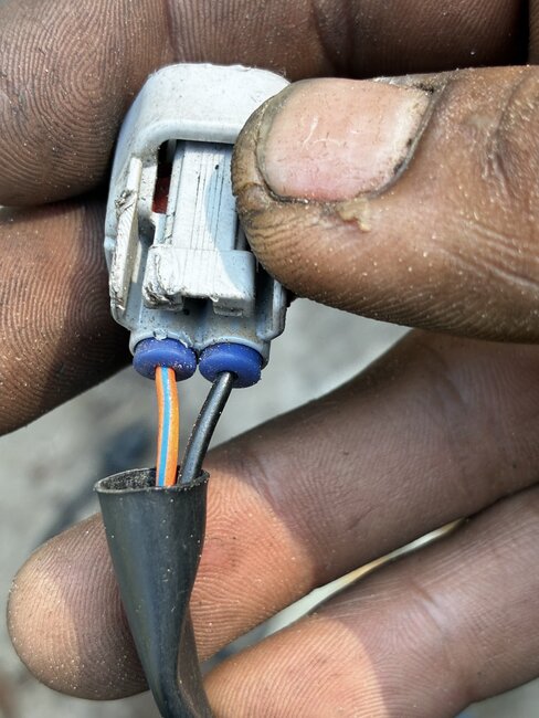

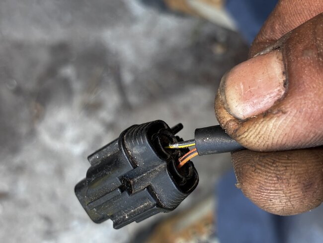

I recently put a new motor in my 2006 Nissan Maxima but I forget were two plugs from the harness plug in at one has a orange, black stripe and black with yellow stripe, and the other plug has a orange blue stripe and black wire

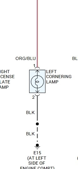

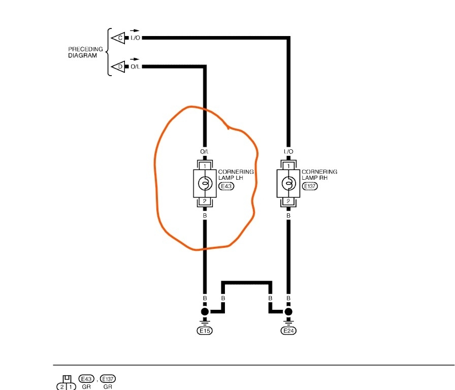

The one on the left - orange w blue stripe and black wire looks like it is the left front cornering lamp behind the fascia

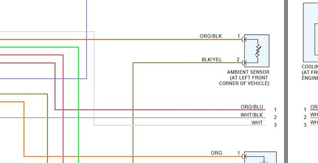

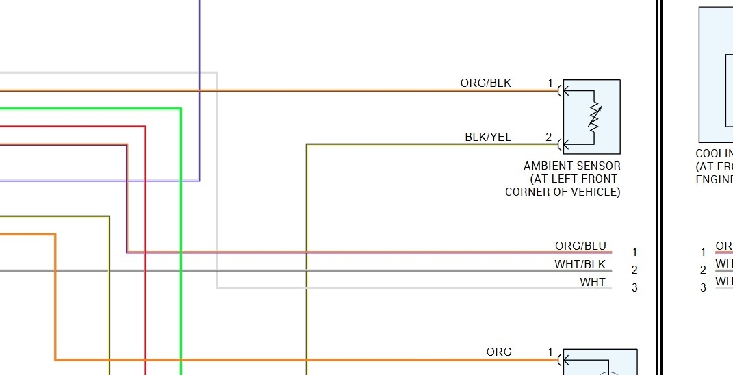

The one in the other pic - orange w black stripe and black w yellow stripe is the ambient air temperature sensor at the front left of the body on the bumper cover at the bottom
