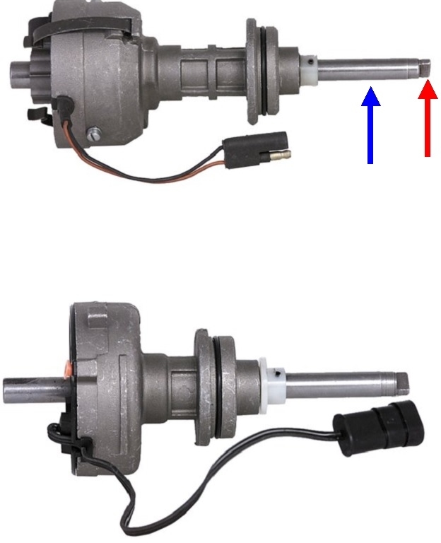

Here's photos of the two distributors. The top one is for your '86. It has no vacuum advance unit hanging on the side, so it will also not have mechanical advance built in. Both are handled by your Engine Computer hanging off the air filter housing. The bottom one is for your '97 360. Note both have the same screwdriver blade end, (red arrow), that is driven by the intermediate gear / camshaft, that also drives the oil pump. The shaft, (blue arrow), also appears to be the same. That makes it a drop-in interchange mechanically. The issue will be with the pick-up assembly inside the distributor. The older one uses a two-wire magnetic pick-up. A few models had distributors with two of those across from each other. I can help with that if necessary, but those are very rare. The air gap for those pick-ups is pretty critical.
The newer distributor uses a "Hall Effect" pick-up assembly with three wires. Those are a 5-volt feed, a ground, and the signal wire. The computer only cares about the signal wire, but that is in addition to the crankshaft position sensor. The computer also supplies the 5 volts to run those two sensors, along with many of the other sensors.
