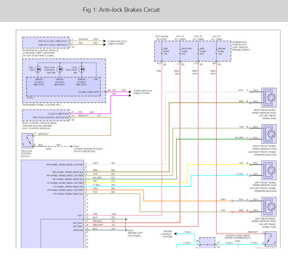

A couple of months ago i bought this vehicle not knowing that the ABS sensor wire harness was cut. after replacing both front wheel hub i don't know how or where that wire goes to to replace it.

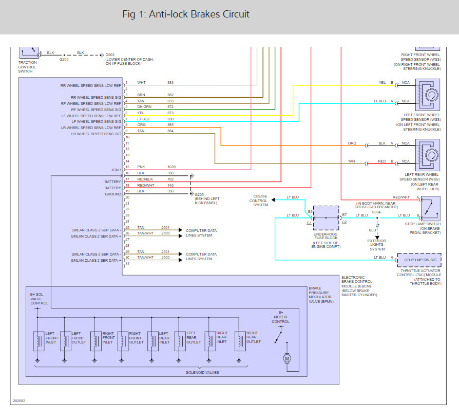

Here is the ABS wiring diagrams you need (below) with a guide to help you test the connections:
