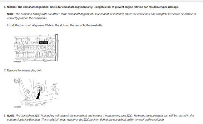

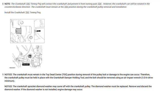

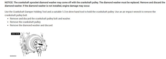

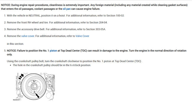

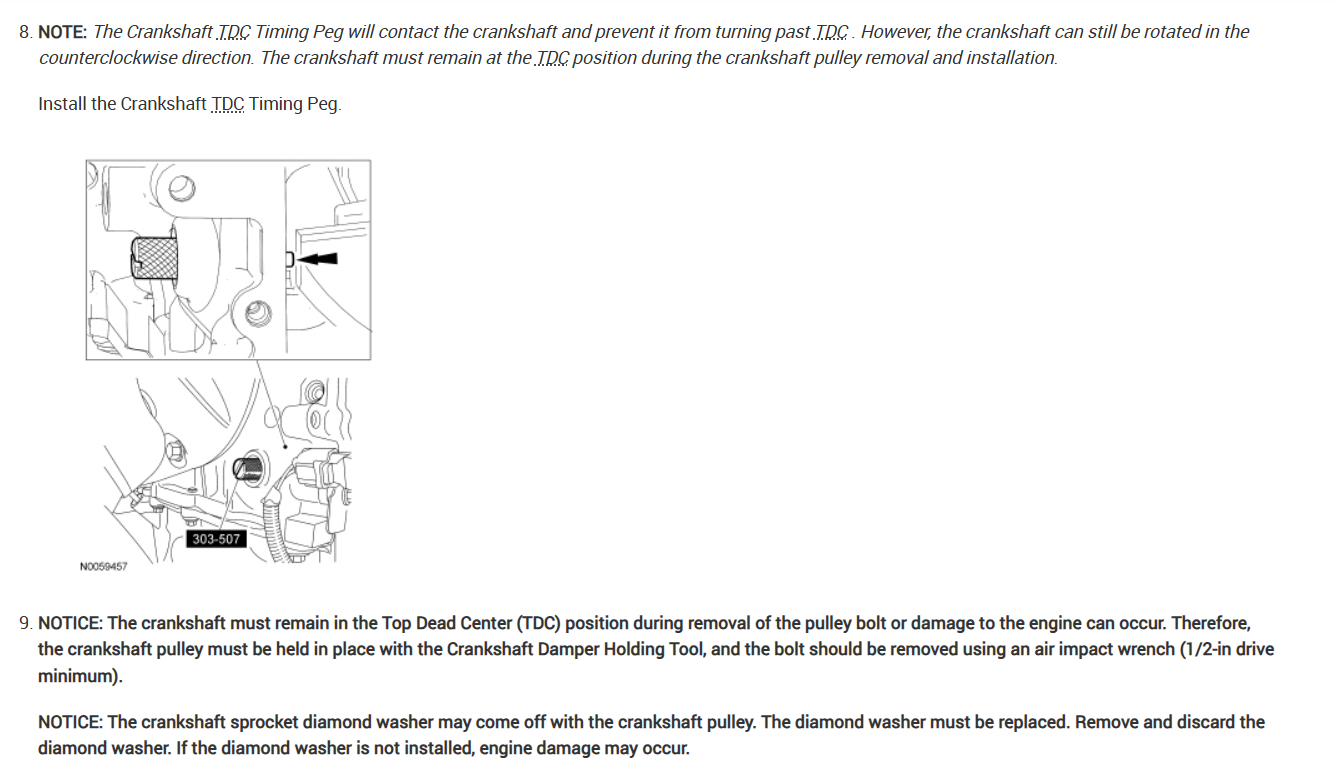

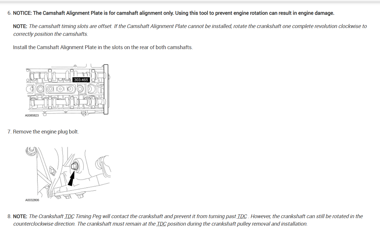

I had to replace my timing cover and took off the harmonica balancer and did not mark it and then proceeded to turn the crank to take off flywheel to prepare for engine stand. What do I do?

Yep, there are specific instructions on how the harmonic balancer is to be installed. Check out the images (below). Let us know if you need anything else.
