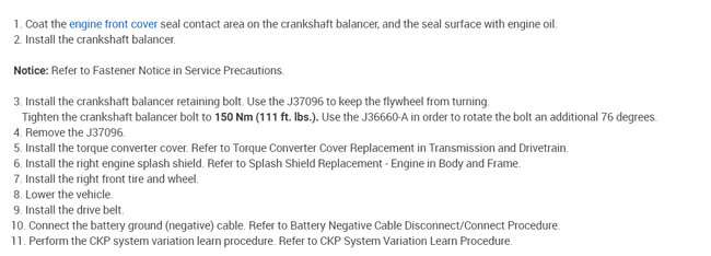

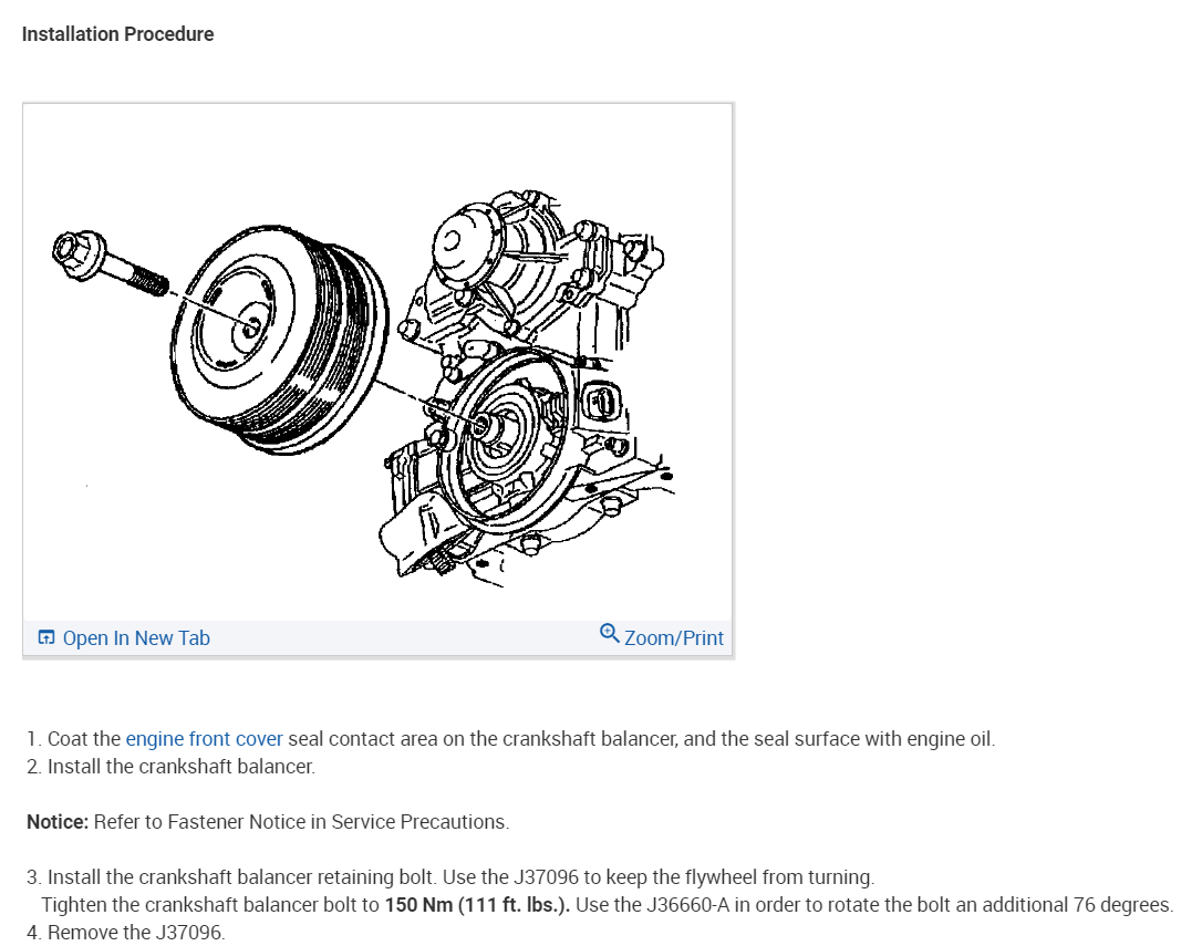

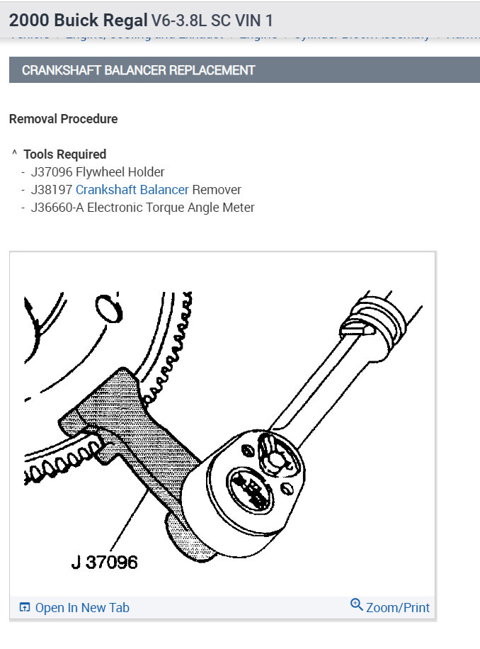

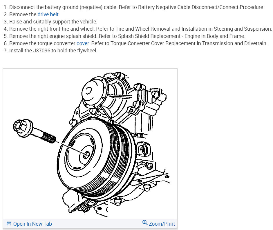

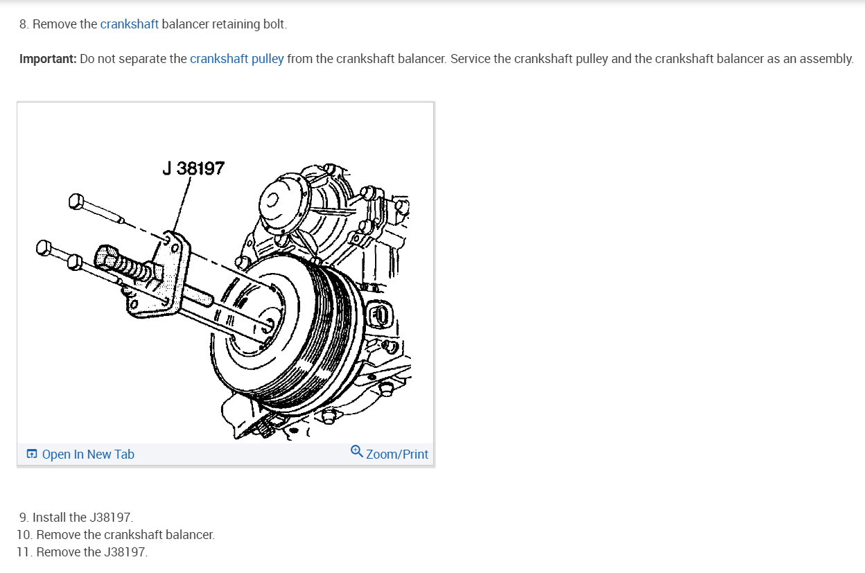

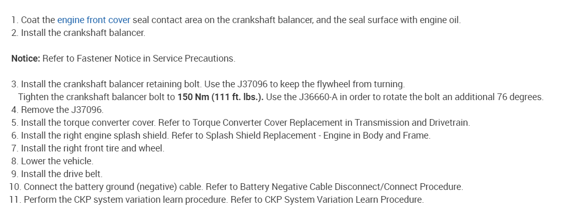

When replacing the Harmonic balancer do I need to consider throwing off the timing of the vehicle? Supercharged Regal, two belts.
Aug 14, 2023 at 5:02 AM
  • 55,433 POSTS
Nope! it only goes on one way you can't mess the timing up. Here are the instructions to replace the harmonic balancer. Check out the images (below). Please let us know if you need anything else to get the problem fixed.
