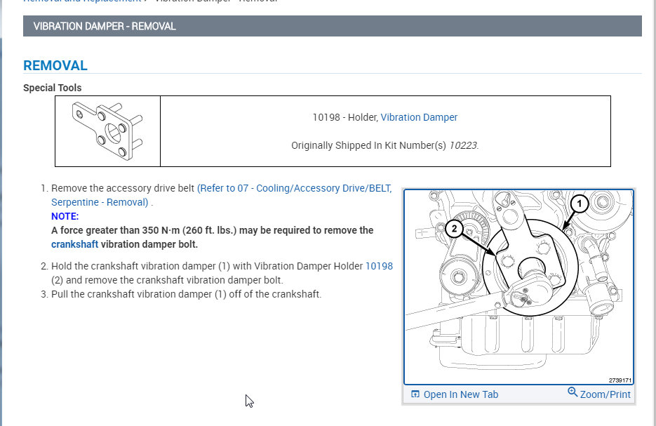

The car listed above has a Chrysler engine. I need to replace harmonic balancer and pull timing cover. Tried to remove with socket and 150ft lbs on air wrench. Using norman counter clockwise rotation to loosen the bolt. Its supposed to be 74-120ft lbs. So am I turning the bolt correctly or is this a reverse (left hand thread tightens counter clock wise, removes clockwise)? Or do I need to apply much more ftlbs to remove the bolt. Thanks

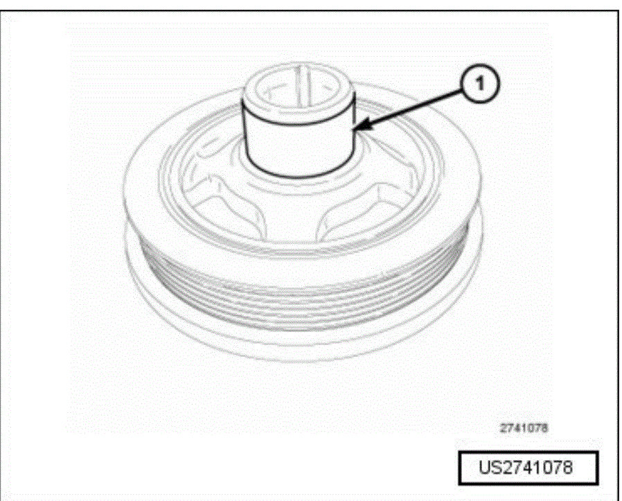

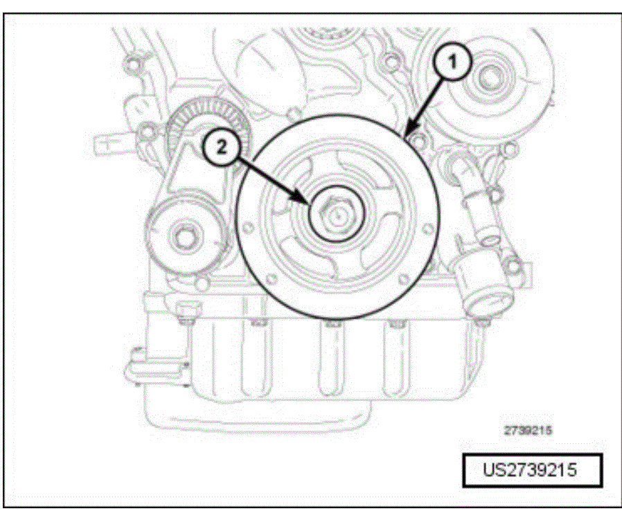

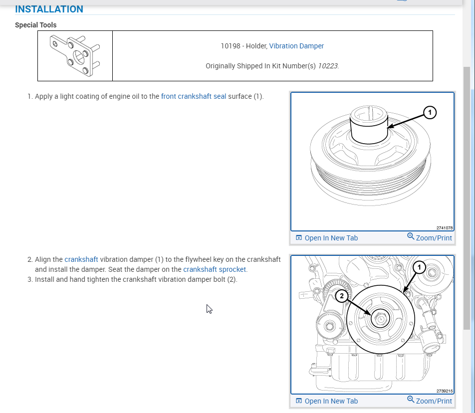

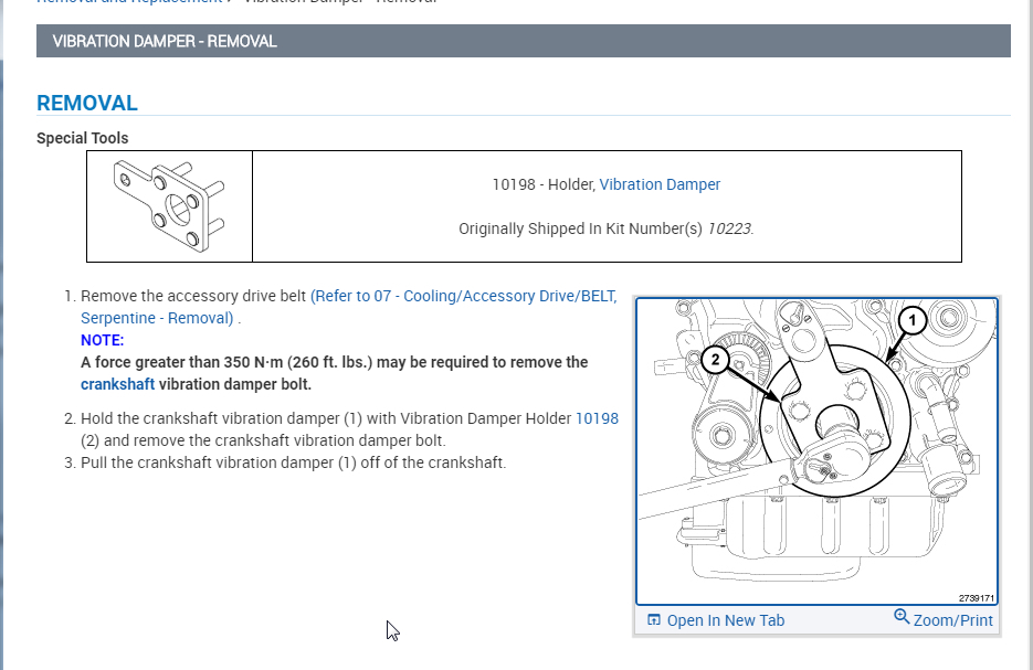

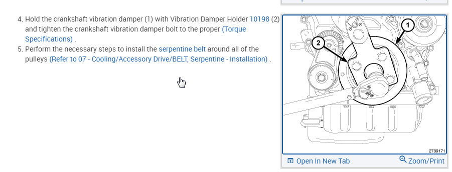

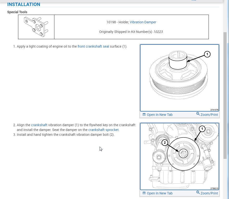

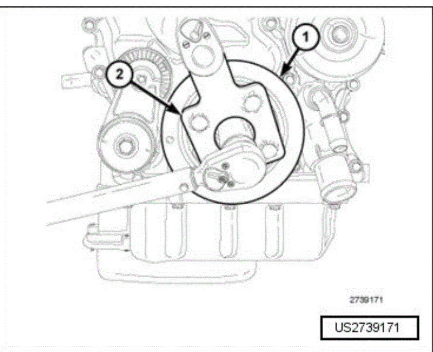

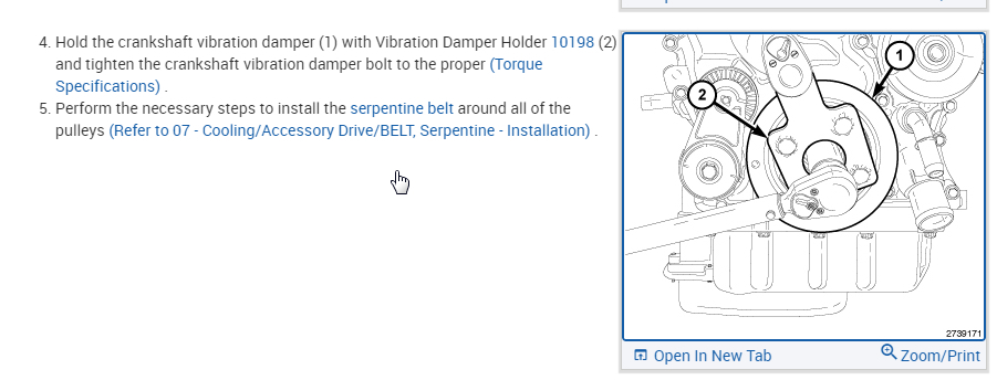

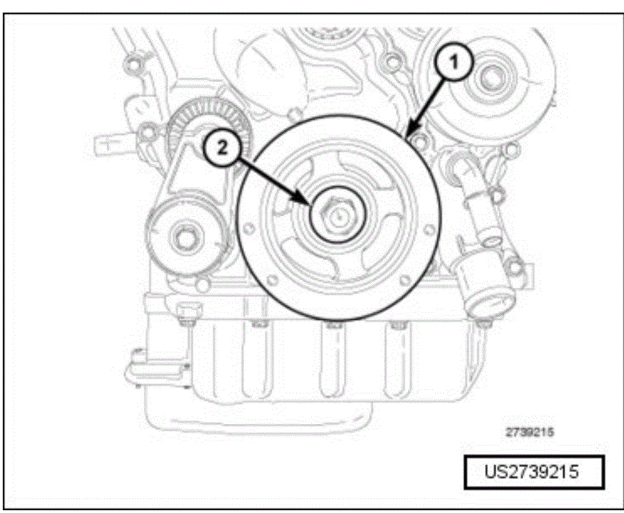

Here are the directions. The attached pics correlate with the directions.
______________________
2011 Volkswagen Routan (7B1) V6-3.6L (CJRA)
Vibration Damper
Vehicle Engine, Cooling and Exhaust Engine Cylinder Block Assembly Harmonic Balancer - Crankshaft Pulley Service and Repair Removal and Replacement Vibration Damper
VIBRATION DAMPER
Vibration Damper
Special tools, testers and auxiliary items required
Vibration Damper Holder (10198)
Removing
pic 1
- Remove the accessory drive belt. Refer to => [ Accessory Drive Belt ] See: Drive Belt > Removal and Replacement > Accessory Drive Belt.
A force greater than 350 Nm (260 ft. lbs.) may be required to remove the crankshaft vibration damper bolt.
- Hold the crankshaft vibration damper (1) with vibration damper holder (10198) (2) and remove the crankshaft vibration damper bolt.
- Pull the crankshaft vibration damper (1) off of the crankshaft.
Installing
- Apply a light coating of engine oil to the front crankshaft seal surface (1).
pic 2
- Align the crankshaft vibration damper (1) to the flywheel key on the crankshaft and install the damper. Seat the damper on the crankshaft sprocket.
pic 3
- Install and hand tighten the crankshaft vibration damper bolt (2).
- Hold the crankshaft vibration damper (1) with vibration damper holder (10198) (2) and tighten the crankshaft vibration damper bolt to 355 Nm (262 ft. lbs.).
pic 4
- Install the accessory drive belt. Refer to => [ Accessory Drive Belt ] See: Drive Belt > Removal and Replacement > Accessory Drive Belt.
Let me know if this helps.

Take a look at the first document. It says a force greater the 260 ft lbs may be needed. Plus if you don't have a comparable tool to hold it then you are going to struggle with getting it off.
Let me know if you have questions. Thanks
