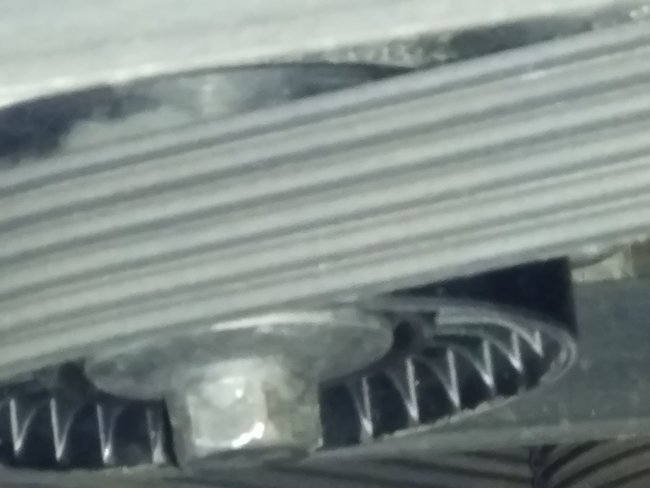

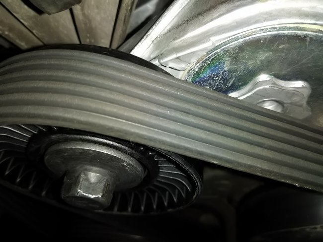

Can you get a picture of the tensioner pulley that you have on there?
If there is not rim on a pulley that has ribs, then I would expect it to walk off.
The smooth idler pulleys are normally the only ones without rims on them to keep the belt from walking.

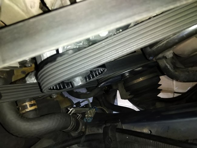

This what it looked like when I shut it off last night. I will have to drive it today; I have no choice it is my only transportation and I already missed 3 days in this period for these problems. These are the best I can do right now. When and if it slips all the way off I will snap another, but am only going to slip the belt back on so I can go to Orielys and Petro station. Thanks CJ
Sep 29, 2021 at 7:58 AM
Okay. That is great. Couple things to start with. First check the parts and make sure they are correct. Both the belt and tensioner just to be sure that is not causing the issue.
Next, we need to make sure the belt is not too loose or tight. Basically, both of these will cause the belt to walk.

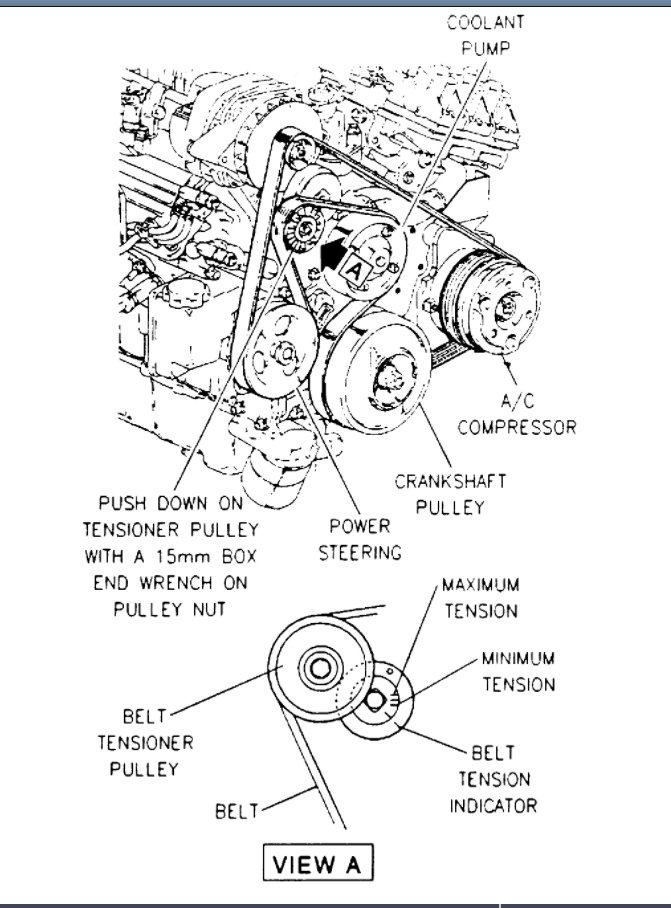

Lastly double check the routing. I attached it below. If you look at this guide, you will see that most tensioners have a rim on them so if you have one as an option that does, I would go with that if all else checks out.
https://www.2carpros.com/articles/how-a-serpentine-belt-tensioner-works
