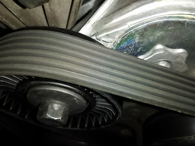

Replaced the belt tensioner. Then harmonic balancer went. Replaced it. Now the serpentine belt slips off. Checked the bearing and it seems to be good it does not wobble or make noise. Cleaned all the pulleys, feel no play in any of them, and the belt itself is only slightly worn, no cracks or breaks. Could there be a slight misalignment between pulleys from those 2 parts exchanges?

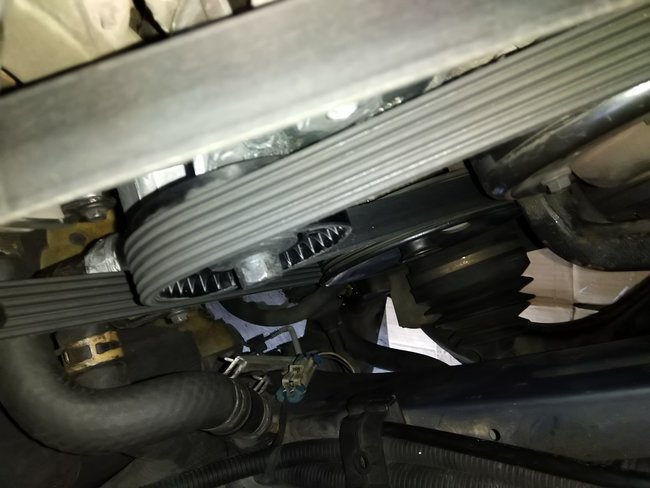

Thank you for your response, after I posted this question, I went ahead and changed the tensioner assembly again. The belt is definitively walking off the tensioner pulley. I just finished and started the ol girl up. It is still walking off the pulley just not as fast. The belt would start slipping and be off with in 5 minutes. I backed he up, drove her forward and it is just now after 10 minutes of running starting to slip. None of the pulleys are wobbling, there is no play and no noise when I spun them during the exchanging of tensioner assemblies. I am at a loss, I also cleaned all of them when inspecting them with a clean no lint rag. I love this darn car and don't want another!

Thank you, I have ordered the belt for pickup. Do you think it wise to change the actual pulley to a metal one with a slight rim?
Sep 28, 2021 at 11:31 PM

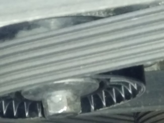

Can you get a picture of the tensioner pulley that you have on there?
If there is not rim on a pulley that has ribs, then I would expect it to walk off.
The smooth idler pulleys are normally the only ones without rims on them to keep the belt from walking.
Sep 28, 2021 at 11:34 PM

This what it looked like when I shut it off last night. I will have to drive it today; I have no choice it is my only transportation and I already missed 3 days in this period for these problems. These are the best I can do right now. When and if it slips all the way off I will snap another, but am only going to slip the belt back on so I can go to Orielys and Petro station. Thanks CJ

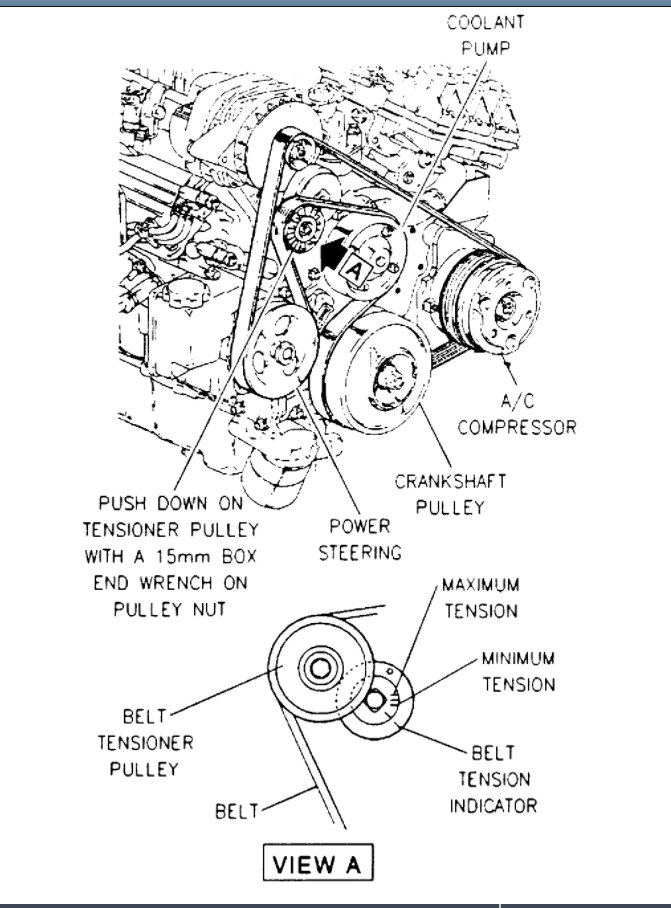

Okay. That is great. Couple things to start with. First check the parts and make sure they are correct. Both the belt and tensioner just to be sure that is not causing the issue.
Next, we need to make sure the belt is not too loose or tight. Basically, both of these will cause the belt to walk.
I noticed you named the word "Petrol" so is this vehicle not in the USA? I see you mentioned it was a 2.0L, is that accurate?
Lastly double check the routing. I attached it below. If you look at this guide, you will see that most tensioners have a rim on them so if you have one as an option that does, I would go with that if all else checks out.
https://www.2carpros.com/articles/how-a-serpentine-belt-tensioner-works
