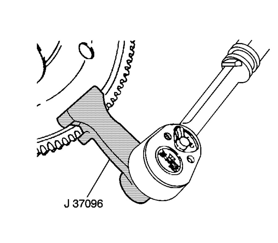

J 37096 Flywheel Holder

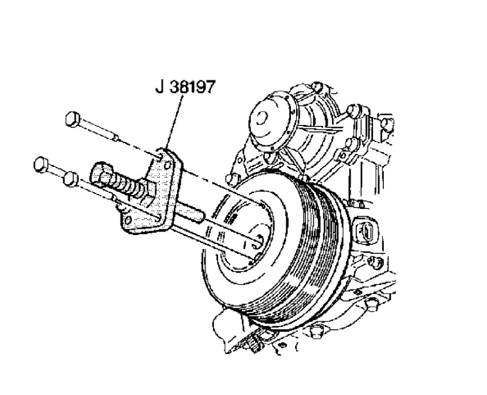

J 38197-A Crankshaft Balancer Remover

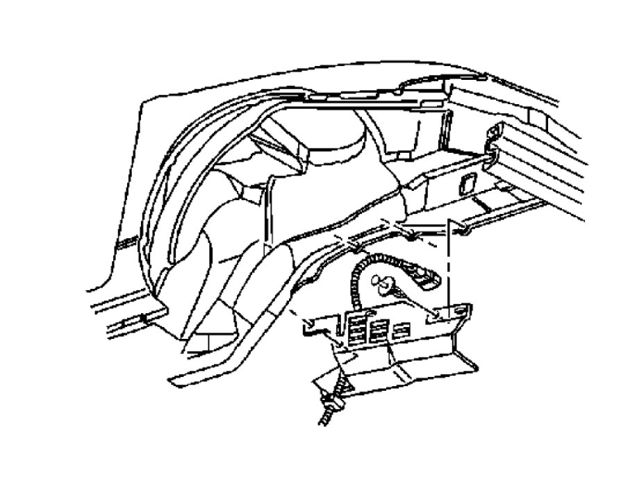

5. Remove the right engine splash shield retainers and the engine splash shield.

7. Use the J 37096 to secure the flywheel in order to prevent the crankshaft from rotating.

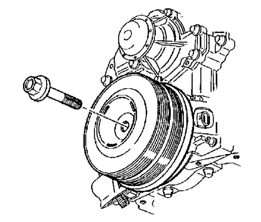

8. Remove the crankshaft balancer bolt and discard the balancer bolt.
9. Install the J 38197-A.
Important: Do not separate the crankshaft pulley from the crankshaft balancer. Service the crankshaft pulley and the crankshaft balancer as an assembly.
10. Remove the crankshaft balancer.
11. Remove the J 38197-A.

My main question is, do you have to drop the sub frame to remove pulley?
Nov 24, 2020 at 8:24 AM
Hello again.
You do not have to drop the subframe.
You access it through the right front tire wheel well.
