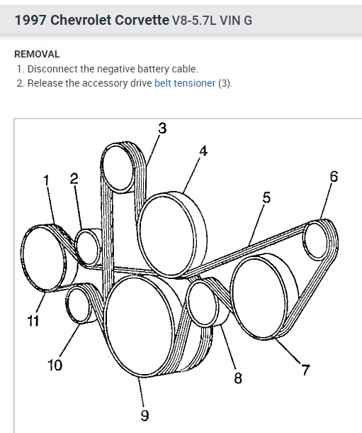

How do I replace harmonic balancer?
Jul 11, 2018 at 12:19 AM
DANNY L
  • 5,648 POSTS
Hello, I'm Danny.

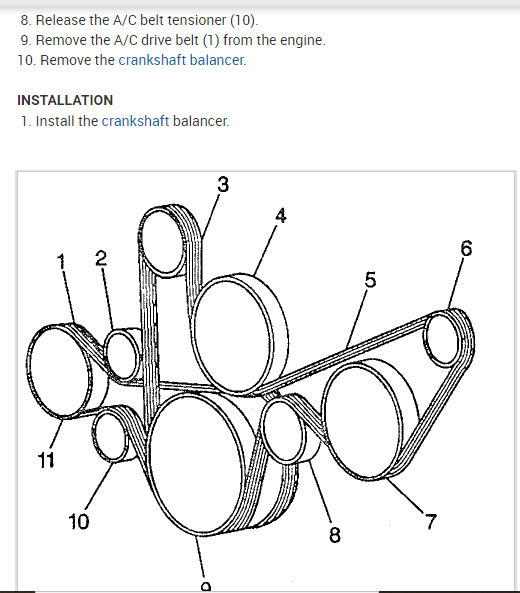

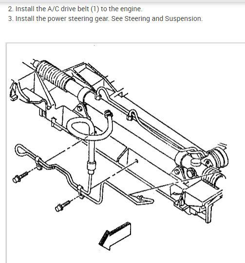

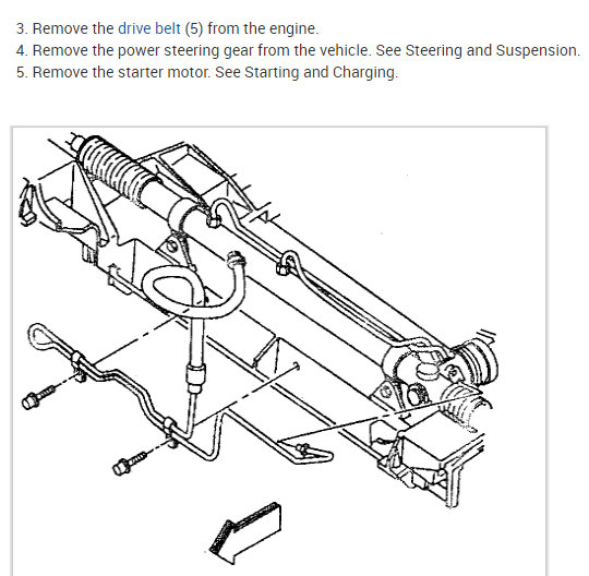

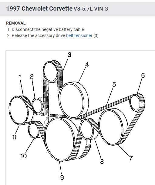

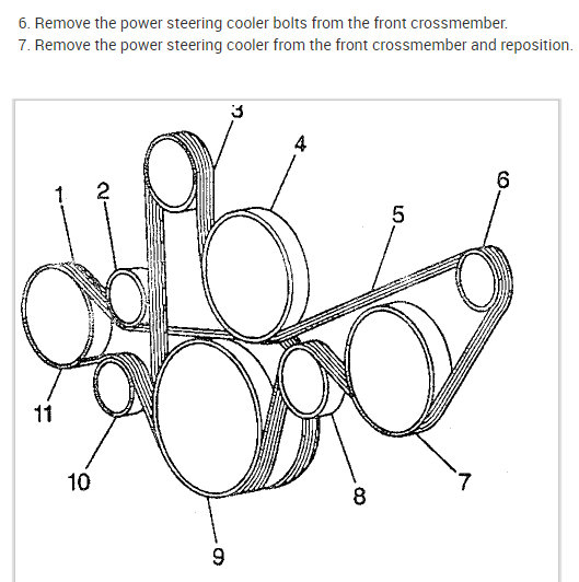

Here is the information you requested. Here is a tutorial for you to view on how to remove and replace a serpentine belt to remove the balancer.
I've attached picture steps below on harmonic balancer replacement for your car. Hope this helps and thanks for using 2CarPros.
