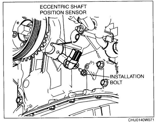

the car start fine but after about 20 minutes driving when i tried to make a u-turn and the stall and would not start again. i have to wait for a minimum of 15 minutes before it will start aging.

Next, what you described sounds like it could be related to a crankshaft position sensor. When they start going bad, heat causes them to fail. Do me a favor, take a look through these links. The first describes the sensor, the second symptoms, and the third explains how in general one is replaced.
https://www.2carpros.com/articles/how-a-crank-shaft-angle-sensor-works
If you feel the symptoms indicated in the aforementioned symptoms link mirror what you experience, the best thing to do is this. One, you can check to see if ignition spark is lost when the engine stalls and fails to start:
Or if you have or have access to a live data scanner, you can check to see if the RPM signal is lost when it fails to start.

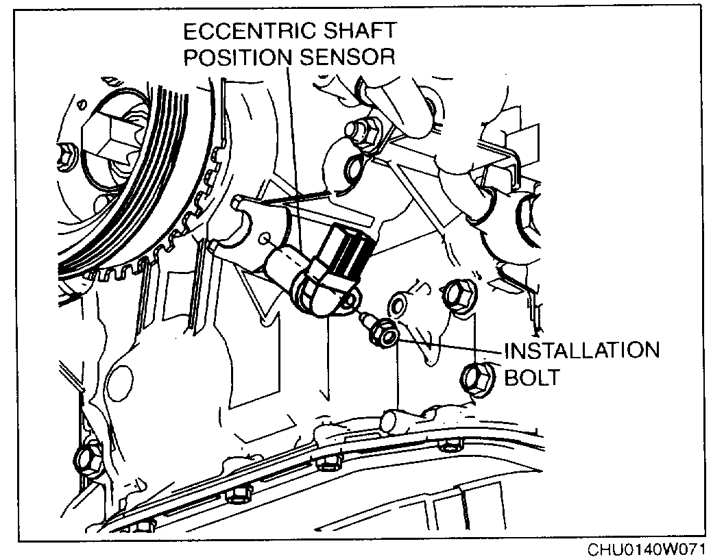

If you determine that the sensor is the problem, the sensor is not too hard to replace. Here are the directions specific to your vehicle. The attached pic correlates with the directions.

Vehicle Powertrain Management Sensors and Switches - Powertrain Management Sensors and Switches - Computers and Control Systems Crankshaft Position Sensor Service and Repair Procedures Eccentric Shaft Position Sensor
ECCENTRIC SHAFT POSITION SENSOR
ECCENTRIC SHAFT POSITION SENSOR REMOVAL/INSTALLATION
CAUTION: When replacing the eccentric shaft position sensor, make sure there is no foreign material on it such as metal shavings. If it is installed with foreign material, the sensor output signal will malfunction resulting from fluctuation in magnetic flux and cause a deterioration in engine
control.
1. Disconnect the eccentric shaft position sensor connector.
see pic 1ckp
2. Remove the eccentric shaft position sensor installation bolt and remove the eccentric shaft position sensor.
3. Install in the reverse order of removal.
Eccentric shaft position sensor tightening torque: 7.9 - 10.7 N.m {80 - 110 kgf.cm, 69 - 95 in.lbf}
