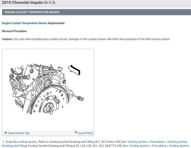

My car barely starts when cold. Runs rough. I give it some gas and it shakes some then then after warming up it is okay. It starts fine after I shut it off after warm up. Codes P0449 and P0442 and P0445 came up when I took it to AutoZone. I replaced to throttle body and the purge valve for the vapor canister. What could I check next?

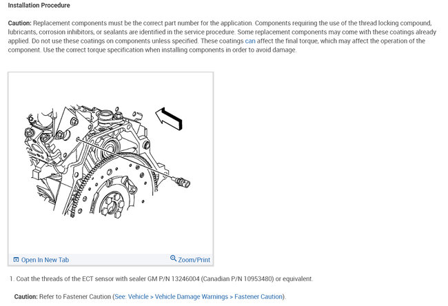

I have seen the engine coolant temperature sensor cause this issue not reading correctly while giving the computer a false reading. You can get a scanner to see what the reading is cold to see if it is close to outside temperature to confirm the issue. here's a guide to help and the coolant sensor location so you can check it out:

Sorry, I missed that in the first post. A vacuum leak will cause hard starting also, I would look into the coolant sensor as well, what happens is the sensor range gets off a little (not enough to give a code) but enough to cause engine problems. Did you clear the codes once the new parts were installed?
