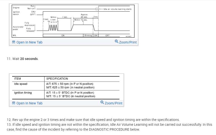

This VQ35 is very hard to get started at times. Other times it's fine. When it does start it acts like it's hunting for time. RPMs are all over the place but eventually settle down. Car runs great otherwise. I've checked everything. I'm thinking the timing chains, but I don't really hear any clatter when on the throttle. Could it be fuel pressure leak down? Please help? Thank you in advance.

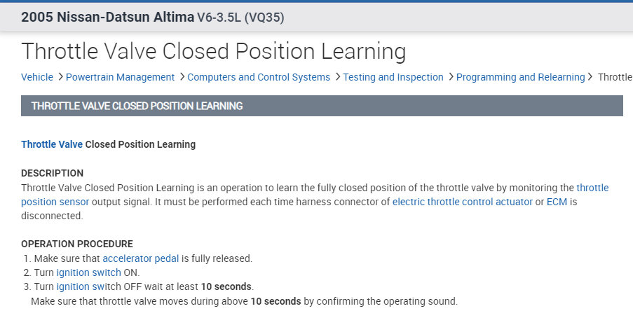

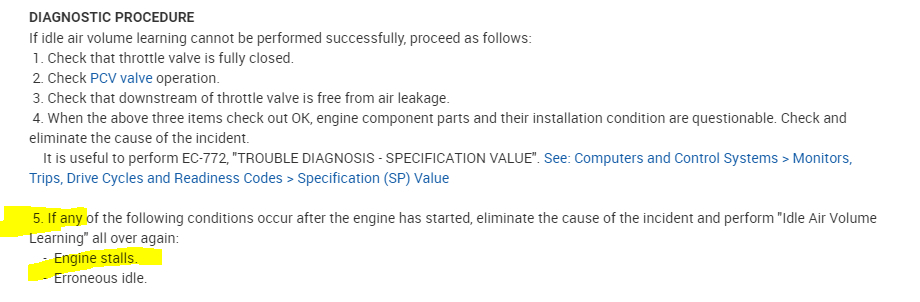

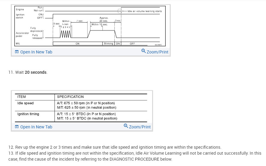

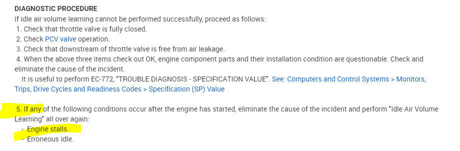

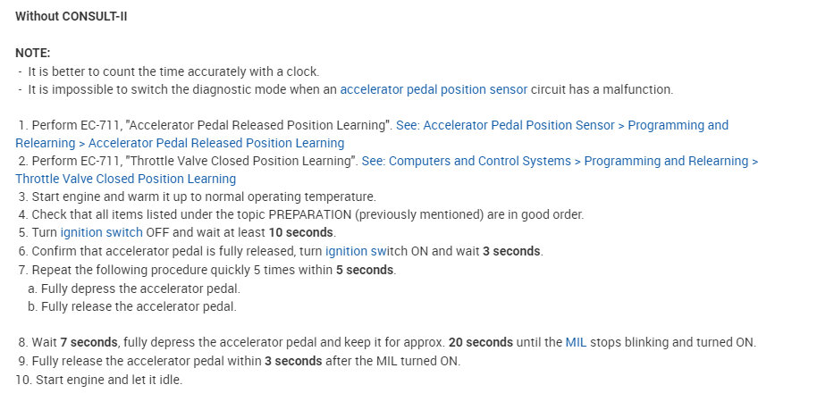

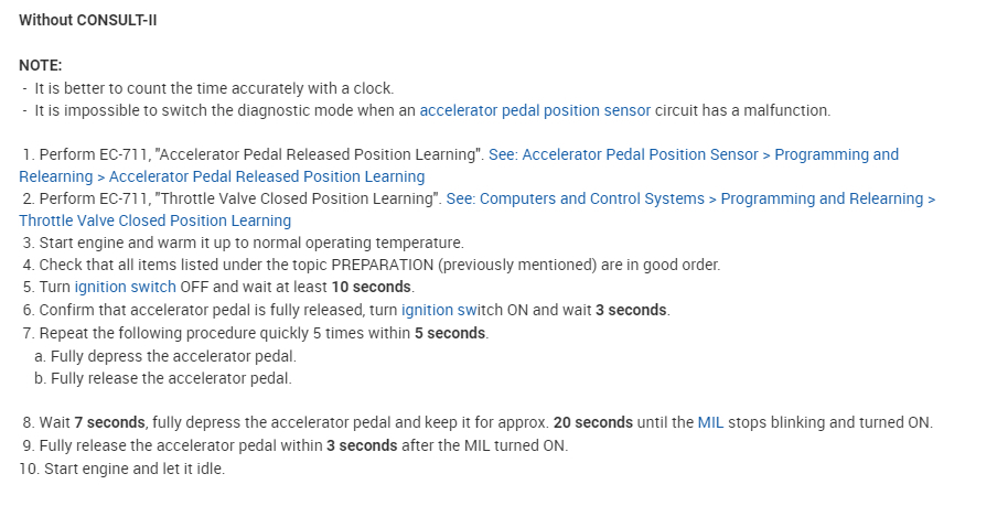

If cycling the key does nothing, let's try the throttle closed and air volume learning procedures. I attached directions below. The first pic is specific to the throttle valve closed procedure. Do this one first. The remaining pics are specific to the air volume learning procedures.
Both of the procedures below don't require a scan tool. If you have one that can communicate and actuate the throttle body/PCM, let me know.
Let me know what you find. Also, let me know if you have retrieved any diagnostic trouble codes.
