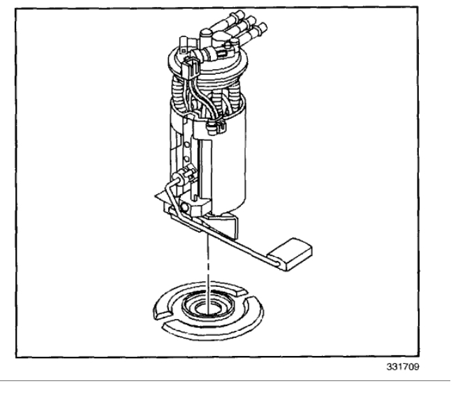

Yes, a weak fuel pump can definitely cause the problem you are describing. To confirm the issue here is a guide to help you check the fuel pressure:
If found bad here is a guide to help you see what you are in for when changing the pump out:
https://youtu.be/Q5MH2gnyFH0
and
https://www.2carpros.com/articles/how-to-replace-an-electric-fuel-pump

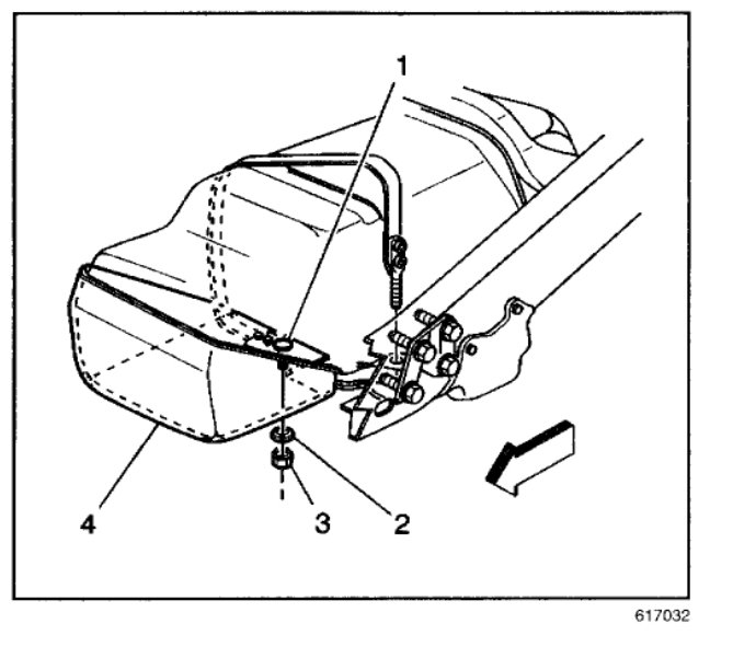

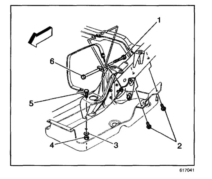

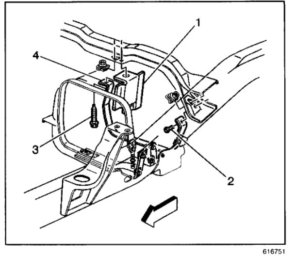

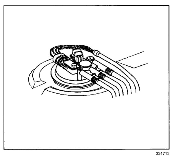

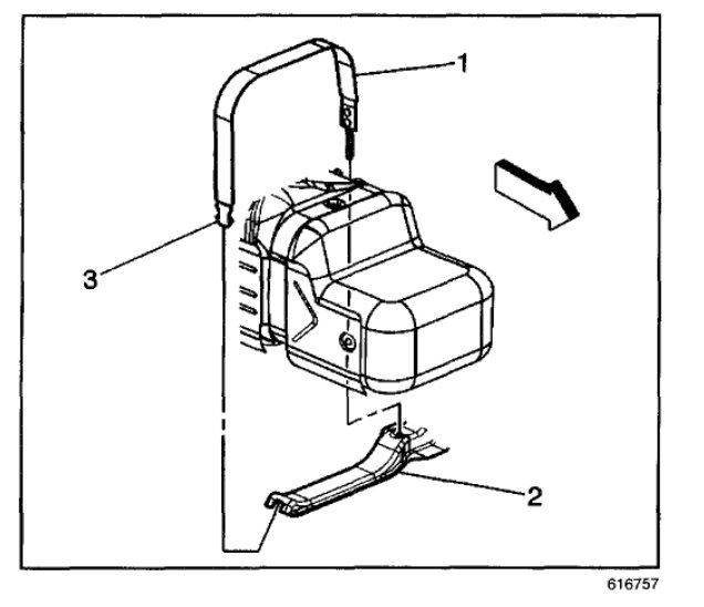

Below are diagrams of what it will be like for you in the your car.
