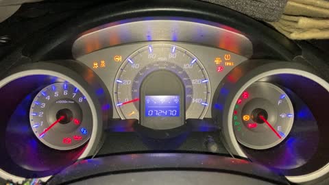

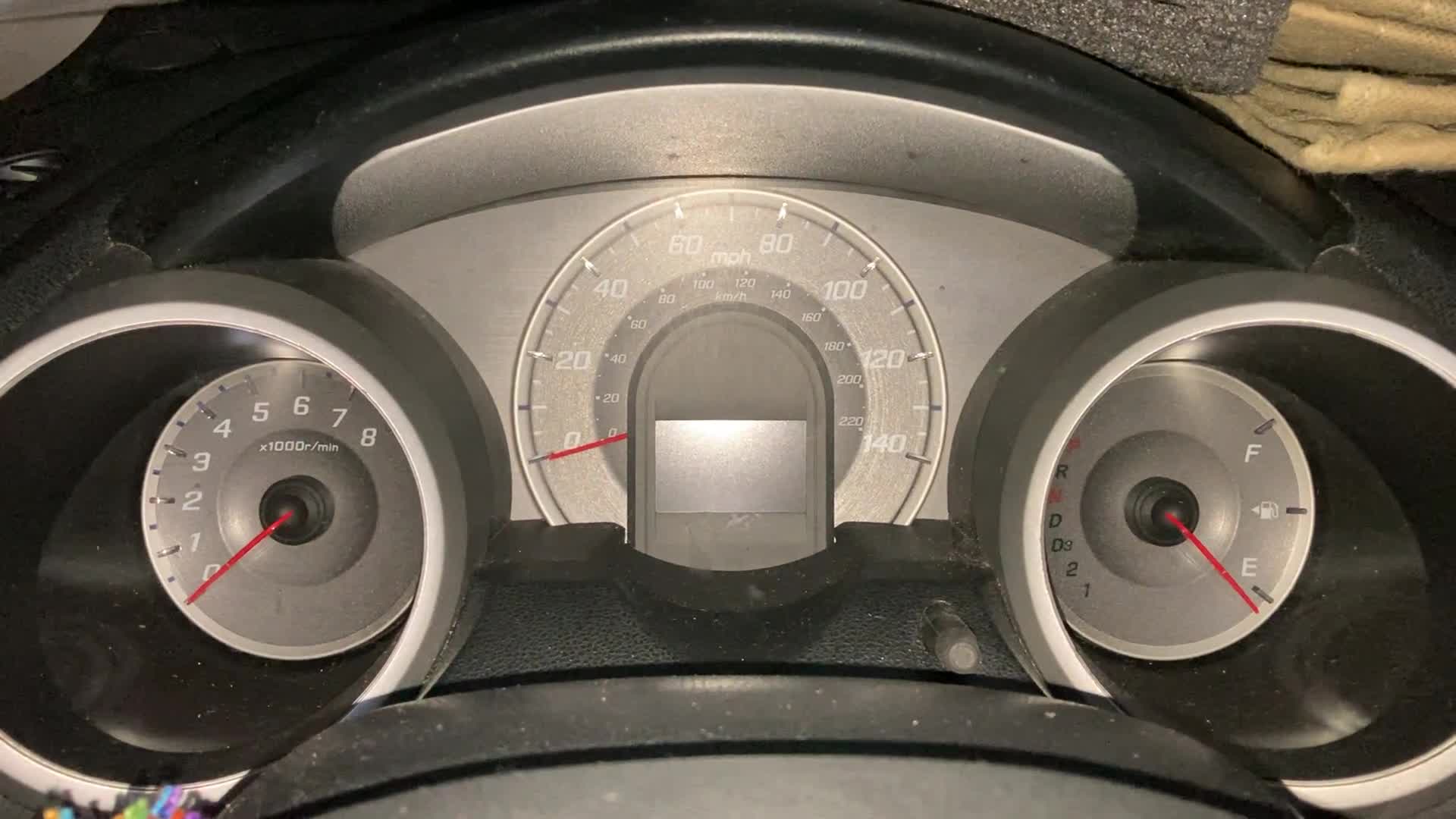

If the car is not driven or sits overnight, it takes hard cranking to turn on the engine. The dash light would be on normally without dimming, there are no clicking sounds. If it is driven, then starting the car afterward is no problem. Then one day after parking the car for 3 days, the car would not even start. There was no cranking sound either. There was still light on the dashboard. I replaced the battery with a new Honda battery and the cranking symptoms still persist. On days that I don't drive, I turn on the engine and let it idle for a few minutes then turn it off then turn it on after many hours later. The engine would turn on but with some cranking but at least it didn't die completely. When the car is driven then again there is no problem with starting the engine.
The attached video shows the hard cranking with the new battery already installed.

The video must not have been uploaded. What you describe sounds like a weak fuel pump or fuel pump drop-off. Have you checked fuel pressure to make sure it is within the manufacturer's specifications?
Try this and see if it will start:
1) From the off position, turn the key to the run position and count to 5.
2) Turn the key off and repeat step 1 four more times.
3) On the sixth time, see if it will start.
Try that and let me know what happens.
Also, here is a link that explains how to test fuel pressure:
