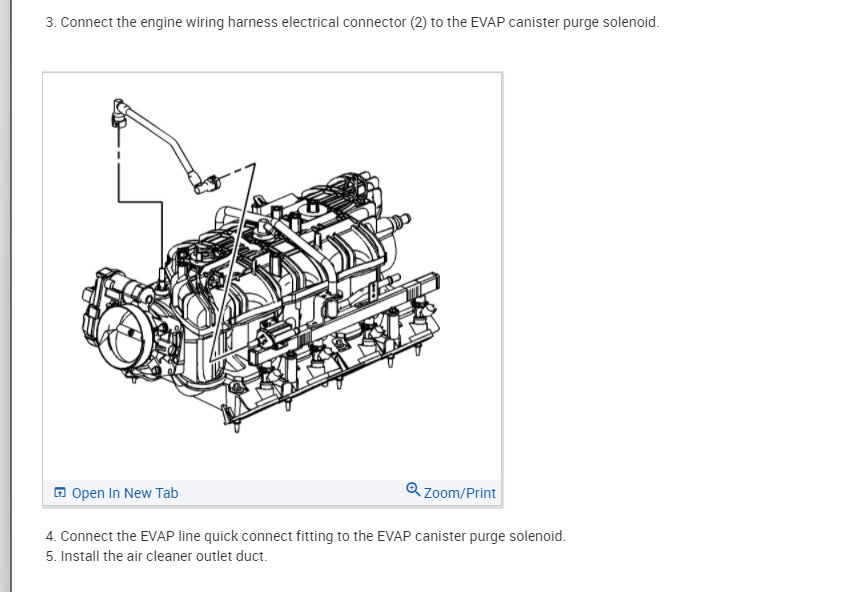

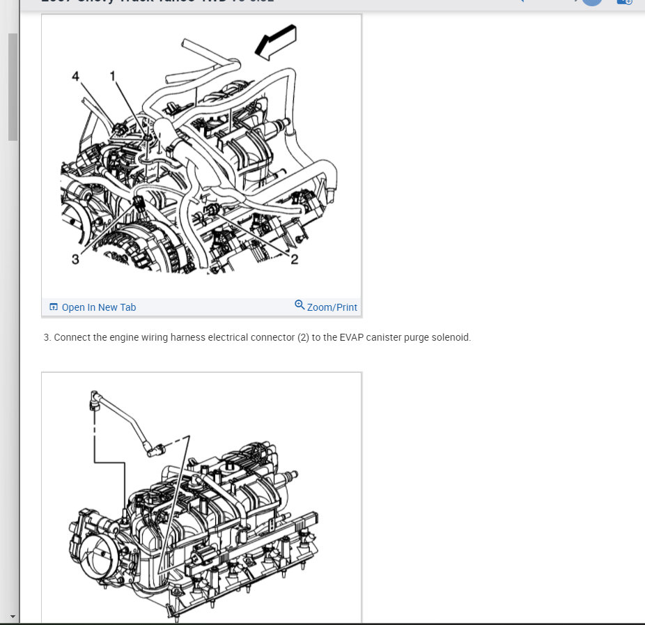

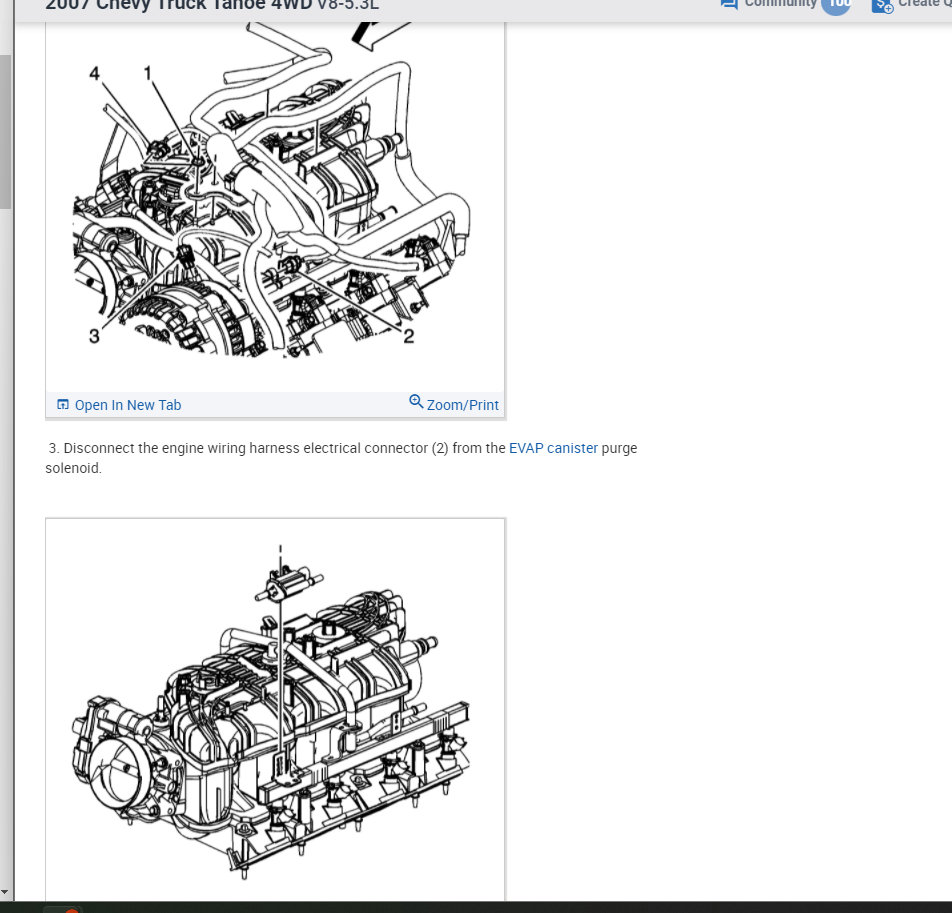

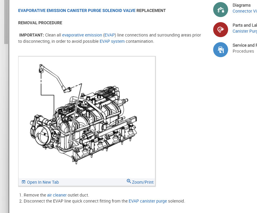

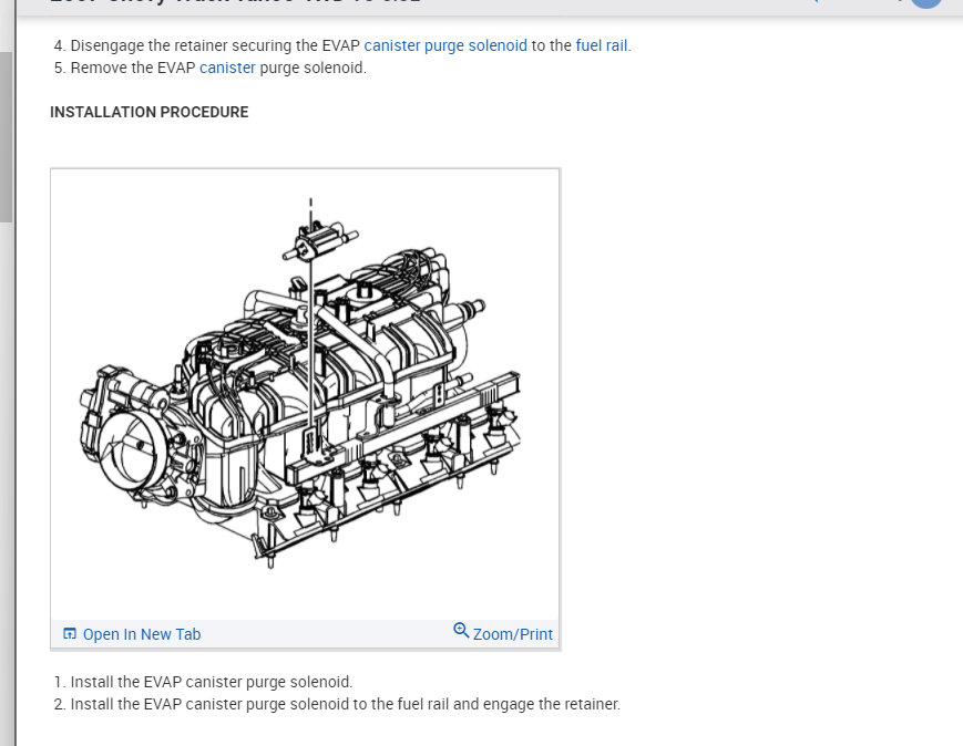

This is due to fuel in the evap system, and the purge valve is stuck open.
Basically, what I would suggest is to replace the canister and the purge valve so that you are ensure to keep this repaired. However, moving forward, make sure you are not topping the tank off when refueling. More than likely the previous owner topped the tank off and it would cause the engine to flood due to the vapor coming in from the evap system.
Here is a guide that will help with this as well.
https://www.2carpros.com/articles/engine-cranks-excessively-before-starting
I am attaching the process below on the purge so let's run through this and let me know what questions you have.
