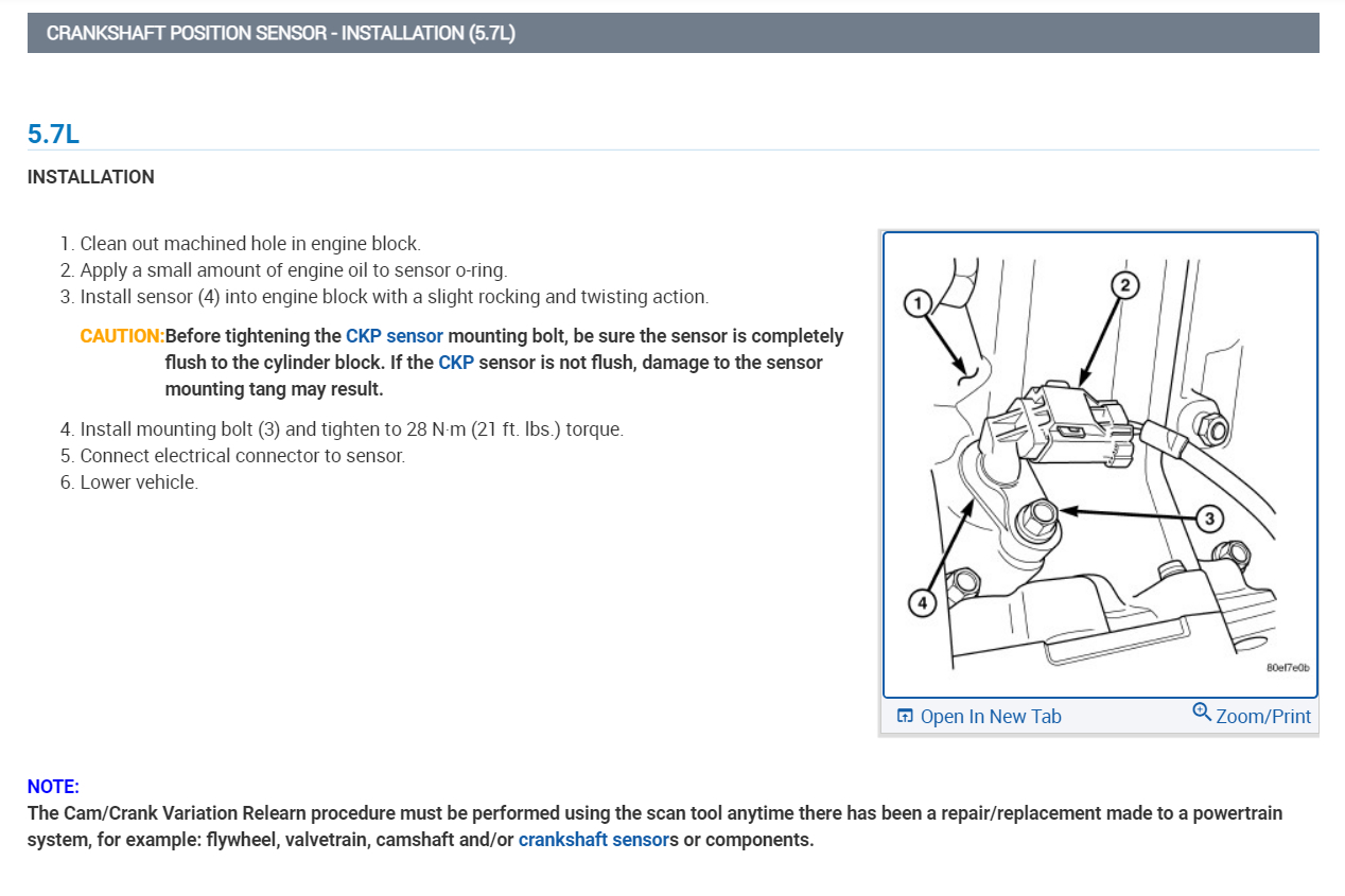

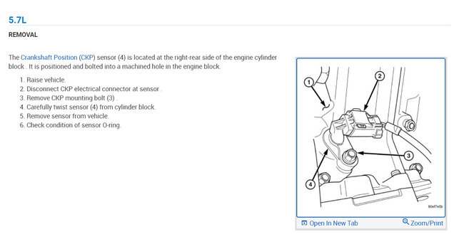

hard to start?
150,000 MILES • V8 • 4WD • AUTOMATIC
BHAMDOC1973
  • 2,007 POSTS
once it starts its okay, codes are p0335, p0523, p0198. Hemi 5.7l.
Oct 23, 2022 at 8:03 AM
  • 55,721 POSTS

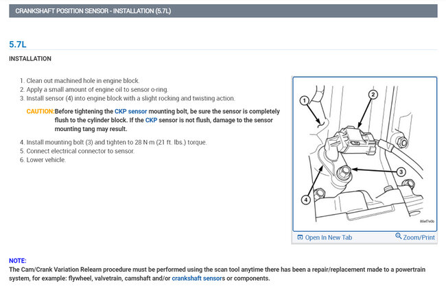

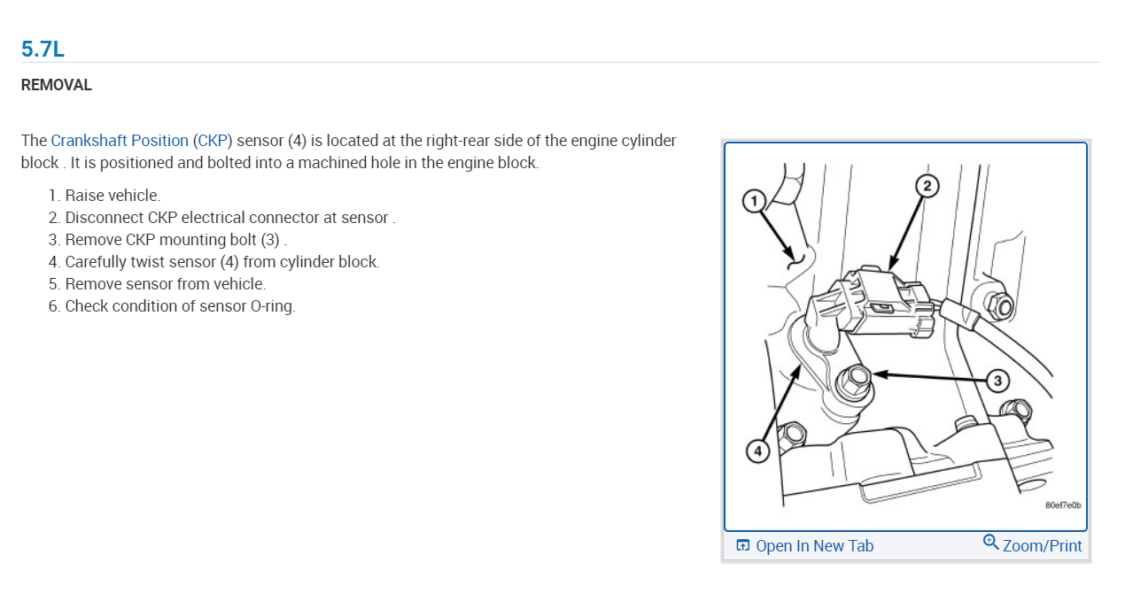

It sounds like the crankshaft position sensor is not working correctly. the P0335 Code stands for Crankshaft Position “A” Circuit Malfunction. So, I would fix that first and then clear the codes out. here is the location of the sensor so you can check it out. Check out the images (below). Please let us know what happens.
Oct 24, 2022 at 2:54 AM
