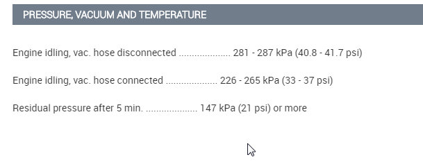

Let's check the fuel pressure when this is acting up and that will confirm it.

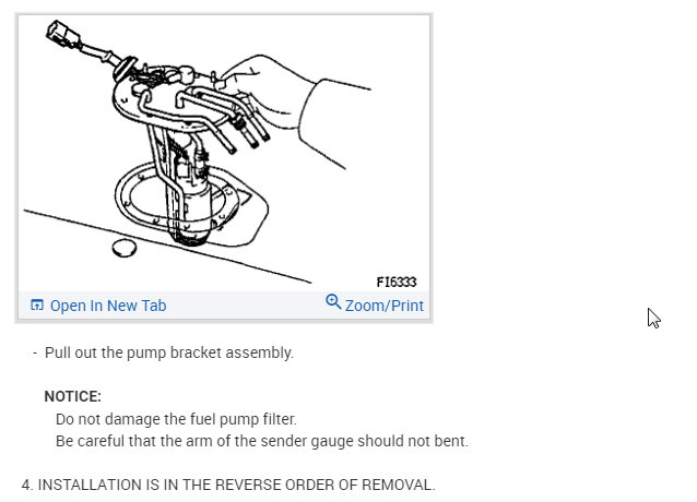

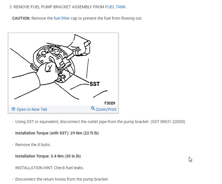

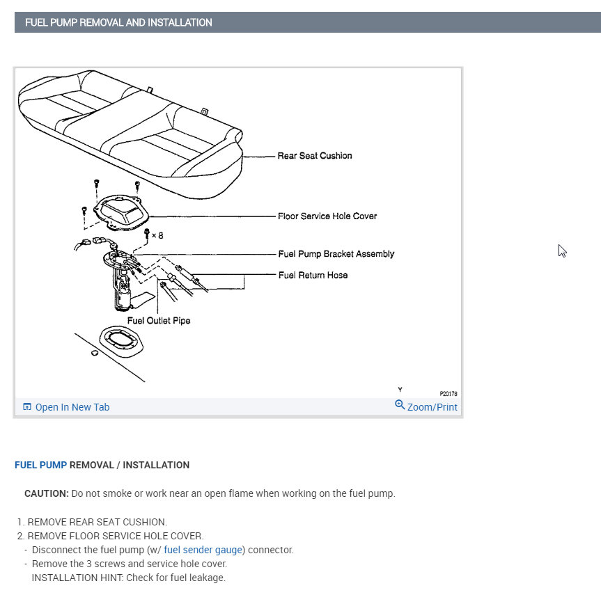

I bought a new fuel pump,bought a new fuel filter but still my car still has a hard start.Now what can be the problem
Nov 11, 2019 at 6:15 PM
  • CAR REPAIR CONTRIBUTOR
Can you get a video of this when it take 3-5 seconds to start? Also, did this just start or did you just buy this vehicle? We should still get the fuel pressure even though you replaced the pump already. Clearly if the pressure is lower when this is happening then there may be a leak in the system causing the pressure to bleed down.
