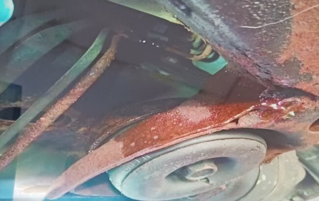

I've taken it to three different mechanics and for some reason, they said they had to "Fabricate new break lines" and something about lowering the cage to fix it.
I'm trying to figure out why they can't find the part somewhere and how hard it would be for me to do this repair myself, even though I have zero car fixing experience.

Here is a picture of the damage the mechanic sent me.

This indicates your mechanics are attempting to save you money. It is pretty much unheard of to buy the exact replacement brake line and try to install it. GM has a history of designing their vehicles to go together quickly on the assembly line with little regard to serviceability later. As such, it is common to "fabricate" new brake lines. This can be done in two ways. Most shops buy new brake line in coils of up to 25 feet. They figure out how long the new line must be, cut that off from the coil, put new threaded nuts on the ends, then form the proper type of flare on the ends. The second way that would work better for you is to buy standard-length replacement sections from any auto parts store, and piece them together.
You won't be able to run the new line right next to the old one as the old one passes through holes in the body and around places you won't be able to fish the new line through. It is perfectly acceptable to route the new line differently, but there are things we need to watch out for. The most important is to not run the new line near hot exhaust or engine parts that could cause the brake fluid to get too hot. Another caution is to avoid having the new line lay on top of sharp edges of sheet metal where it could vibrate and rub through. The new line should be anchored to hold it from sliding and vibrating.

If the leaking brake line is for a rear brake, it would be smart to replace both of them. Each rear wheel has a separate line that often rusts out under the left doors. When one has rusted through, the other one is just as old and is about to rust out too. Front lines are different. They run in different areas, and are affected differently by salt and water.
For the new line, when a mechanic makes the new one, he uses a special flaring tool. The common one costs around $50.00 and requires some experience to do it right. There are some newer, very expensive tools now that work really well, but take some time to learn. You can often borrow these tools from an auto parts store that rents or borrows them. In my city, they make you buy the tool, then you get a full refund when you return it. If you choose to keep it, you still return it, then they give you a brand new one.
For do-it-yourselfers, the better approach is to use premanufactured line sections. Either measure how long the line must be, or plan on making additional trips to the store. The common diameter is 3/16". You must match the type of flares on the ends. If you don't know the type, remove the ends, break them off and take them to the auto parts store. They will have a selection of lengths to add up to the total length you need. The nuts on the ends are soft metal, so "flare nut" wrenches are recommended. Also called, "line wrenches". Soft brass couplers are used to connect two line sections.
