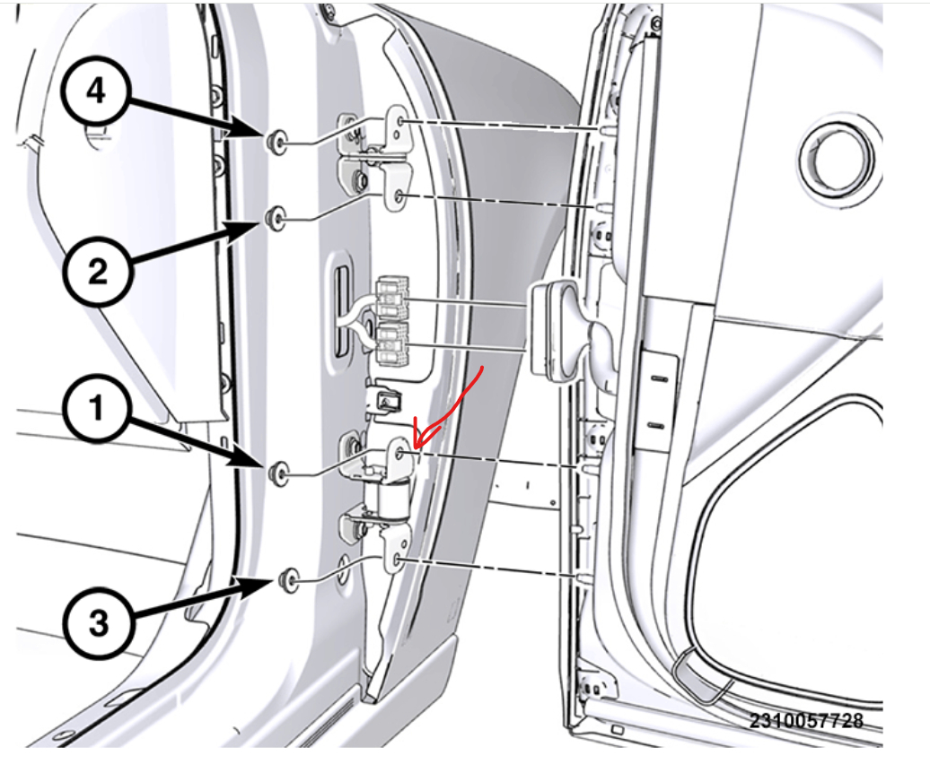

Thanks for the video. That is a good one, it must be the door dampener that needs to be replaced, also can you tell if the door has been "sprung" (bent backwards?) The dampener is built into the hinge, I would try WD40 first. Check out the images (below). Please let us know what happens.
