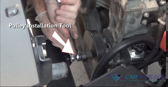

One last thought. If the new pump didn't come with the pulley attached and you had to install it, make sure it is full seated and not slipping. Pic 1 shows the install of the pulley using a specific type of tool.
Let me know if that is what was done.

When i first start the car i am able to turn the wheel a few times at idle then it locks up. It does make some noise. The pump does not whine after that and it's quiet while driving. Its just not turning when at idle or when i take my foot of the accelerator. That is why i was wondering if it could be air. When it was raised up the steering turned. But when its down and there is weight on the tires it locks up. The pump i bought a month ago with the new rack and pinion turned while idle but whined and leaked so i we replaced it with this one. The existing pulley was reused because the new one didn't come with one. So it is possible that the pulley isn't fully seated. That I will have to get checked out.

Let me know about the pulley. Also, when you say it locks up, do you mean it is unturnable or do you mean you lose power assist? If it nearly impossible to turn, it sounds like the rack is bad. I have seen the bushings inside go bad and when pressure is placed on it, the system would jam. On the other hand, are you certain that everything was installed correctly as far as pressure lines and so on? Something isn't adding up. Are the rack and the pump re-manufactured? Did you notice if there are any air bubbles in the fluid?
