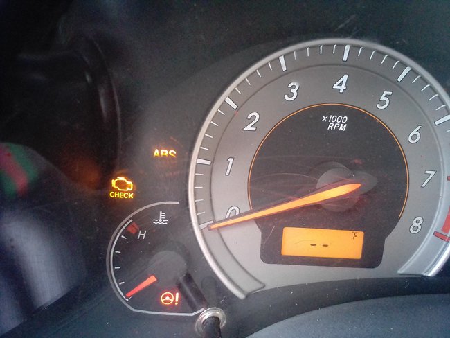

That's another light that I captured- the ABS light. But their major concern was the hard steering wheel.
I also noticed that the deflated tire pressure light was on, on the dashboard.
In addition, I noticed that the dashboard steering wheel light as the mechanic showed me in another Corolla that he was working a different thing on but same model and year, I observed that there was a discrepancy there. In the car I worked on, with a hard steering- the steering wheel light remained on after it started but on the other car that the mechanic was fixing a different issue the steering wheel light went off a few seconds after it started.
He related to me that the steering wheel light should go off after a few seconds when the car starts and idled, and I saw and understood vividly what he was saying.
Apr 30, 2022 at 9:42 PM
Okay. If the brake module was the one that was releasing smoke, then that would make sense why we have that light on now.
However, we should have some codes directly related to that at this point. If we don't then let's address what we know we have and then any other issue that is not repaired by the steering issue.
Let us know what happens this week and we can go from there. Thanks
