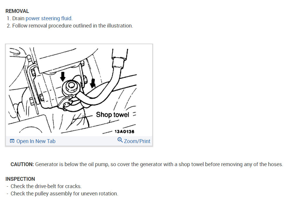

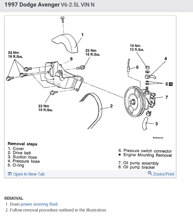

you are doing nothing wrong the system self bleeds instantly. The problem is the system is sucking in air from the pump seal, I would get another unit (high quality). Here is a guide to help you step by step with instructions in the diagrams below to show you how on your car. Check out the diagrams (below). Let us know what happens and please upload pictures or videos of the problem.

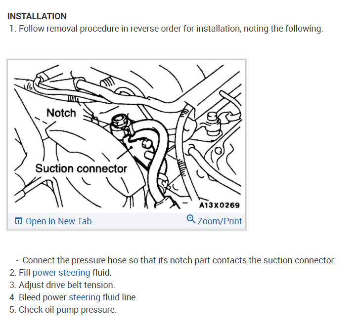

Good evening, i have finally got my new pump and installed this evening still have to flush out the system. Well, while installing the new pump i was looking at the diagrams you sent me and where the pressure hose connects to the top part of the pump i noticed it has 2 o-rings well the first one i had i only installed just one o-ring. so, i'm thinking when trying to bleed the system it wasn't getting the air out i'm thinking instead the pump was allowing more air into the system. thinking to myself i bled the system and why it took longer than it should have. I did in fact install the 2 o-rings and connected the hoses and hopefully everything going better.

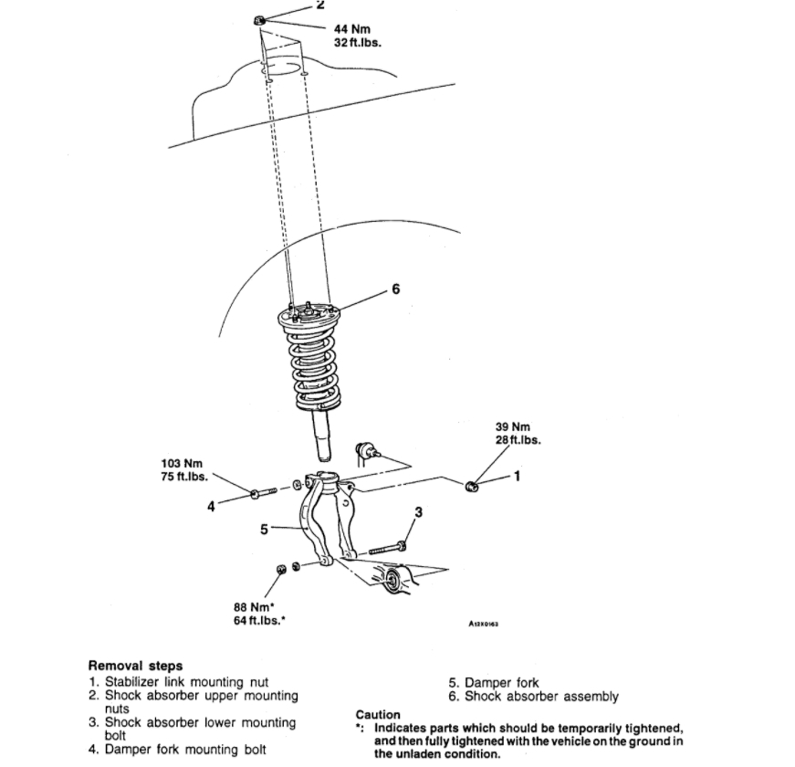

I am wondering if the upper strut mounts are bad not allowing the steering to move freely. Here is how you can replacement, Of course you will need to have the rack redone but something must be causing this to happen. Check out the diagrams (below). Please let us know what you find.
