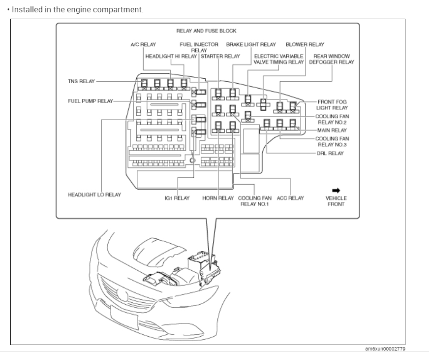

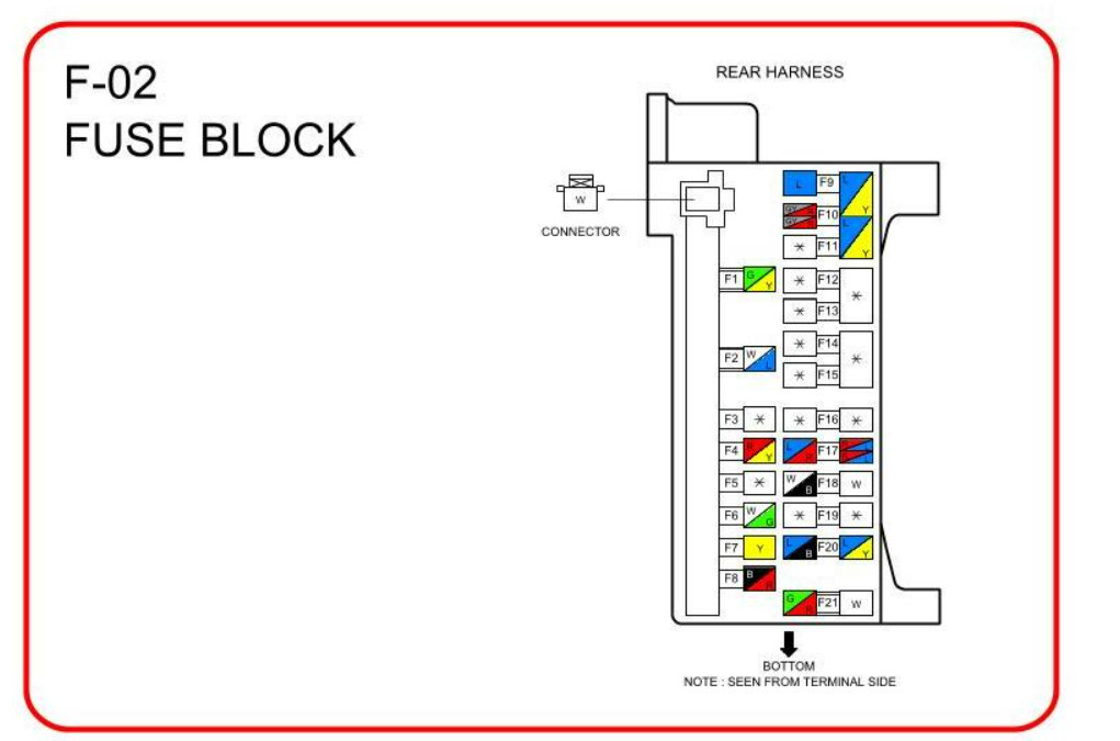

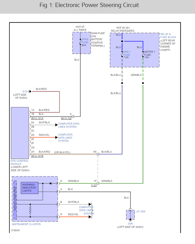

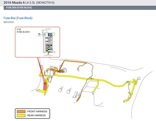

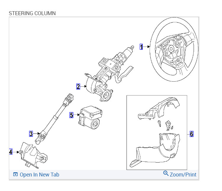

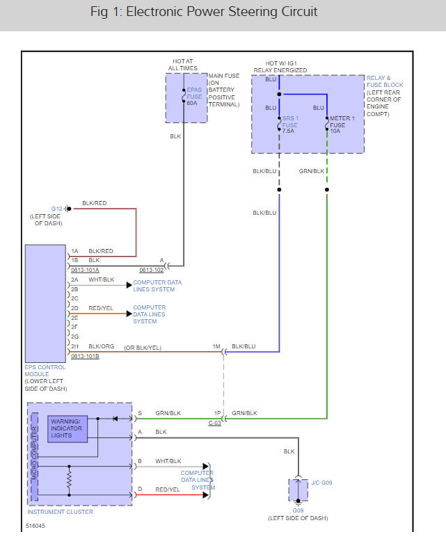

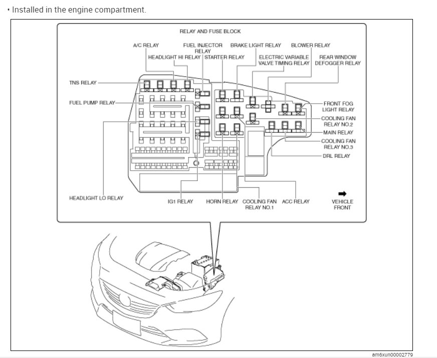

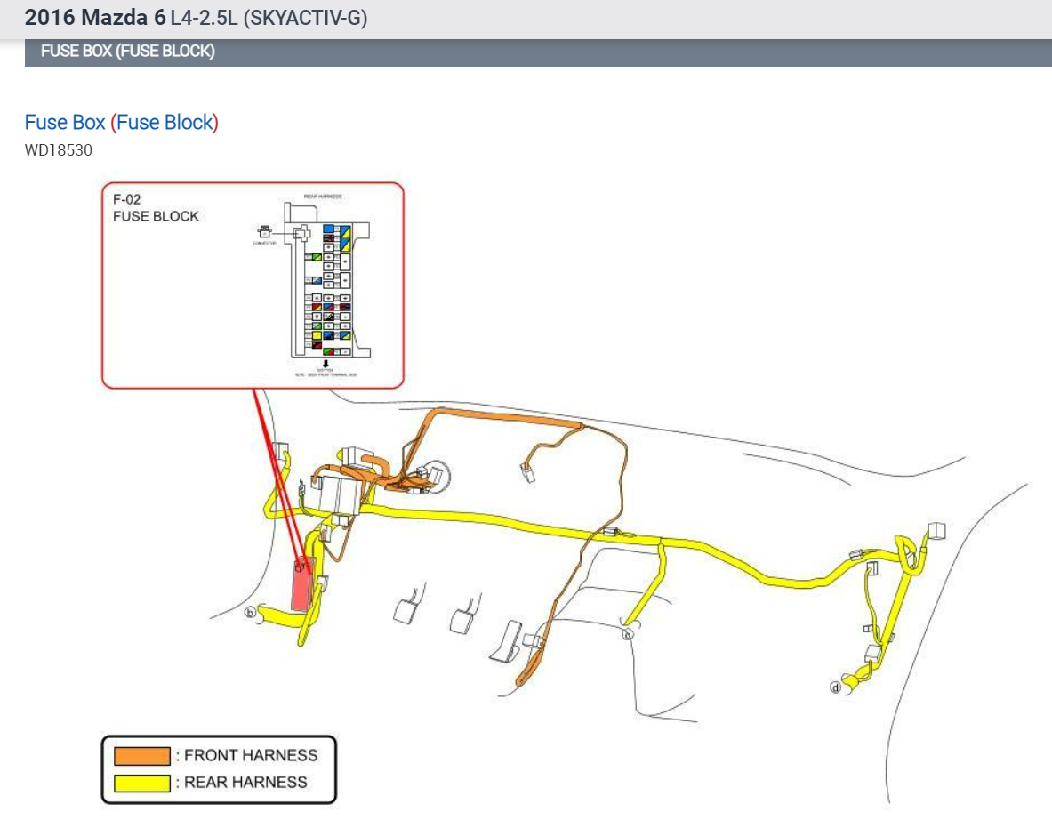

It is hard to say what he did, I would say start by checking the fuses for the steering system. This guide will help, and I have included diagrams of the steering system that show how the system works and which fuses (SRS, meter1) to check to get us started:
Maybe you can look at these images and give us more info on what the mechanic did. Here are the fuse locations as well. Check out the diagrams (below). Let us know what happens and please upload pictures or videos of the problem.
Jun 20, 2022 at 4:48 AM

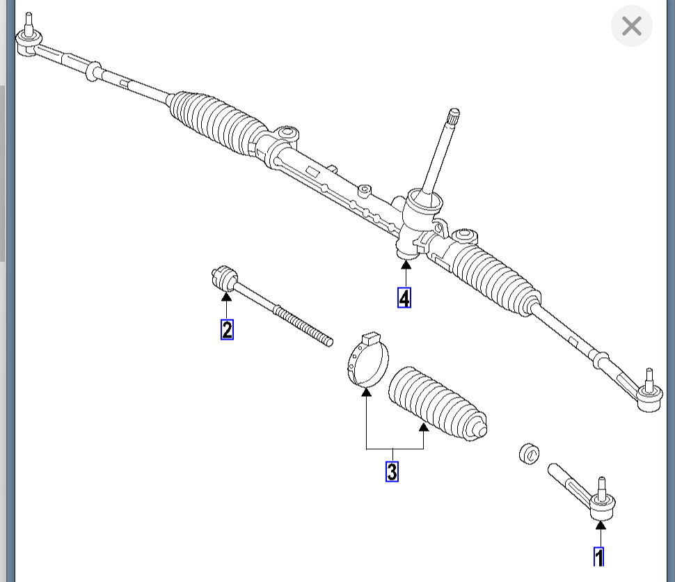

This is interesting because I don't know what he would have done in order to cause this.
Do you think you could get him to write down exactly what he did and then I will be able to read in his words so that we can try and figure out what he did?
Unfortunately, based on what you are describing, I am not able to pinpoint what he may have done.
Otherwise, are you able to see anything in the image below what he may have been messing with?
https://www.2carpros.com/articles/how-to-check-and-fill-power-steering-fluid
The fact that the steering is tight means we have an issue with the pump, or he tightened the actual steering gear.
Let me know what you can find and if he gave anything in writing, please post a picture of it.

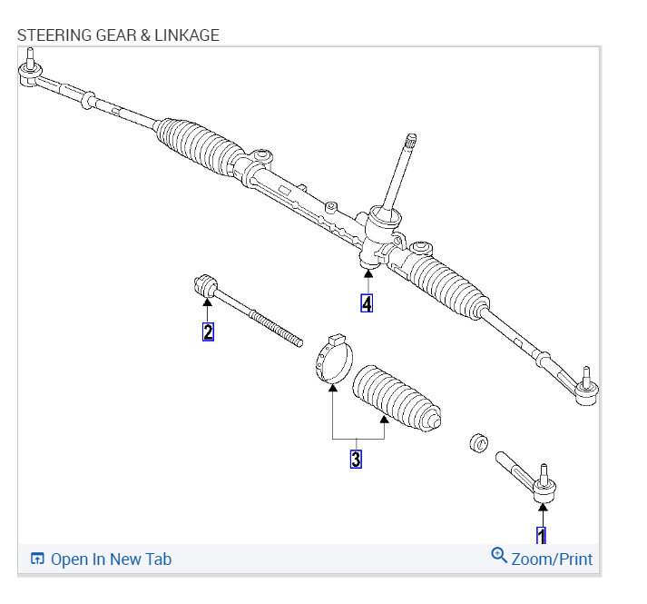

Okay. So, this is why we are going to need a little more clarification as to what the exact part that he replaced is. The bushings are what mounts the rack to the vehicle. They are external and so we have conflicting info.
I am sure we can explain this, but we are just missing the exact details as to what he did. If he did something internal to the steering rack, then I am confused on what bushings that would be.
