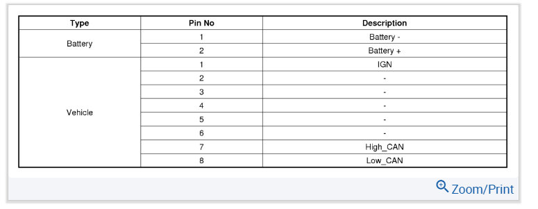

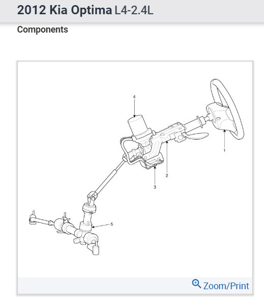

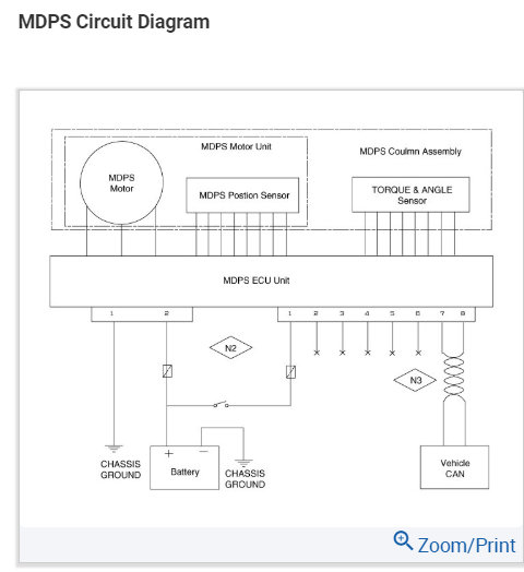

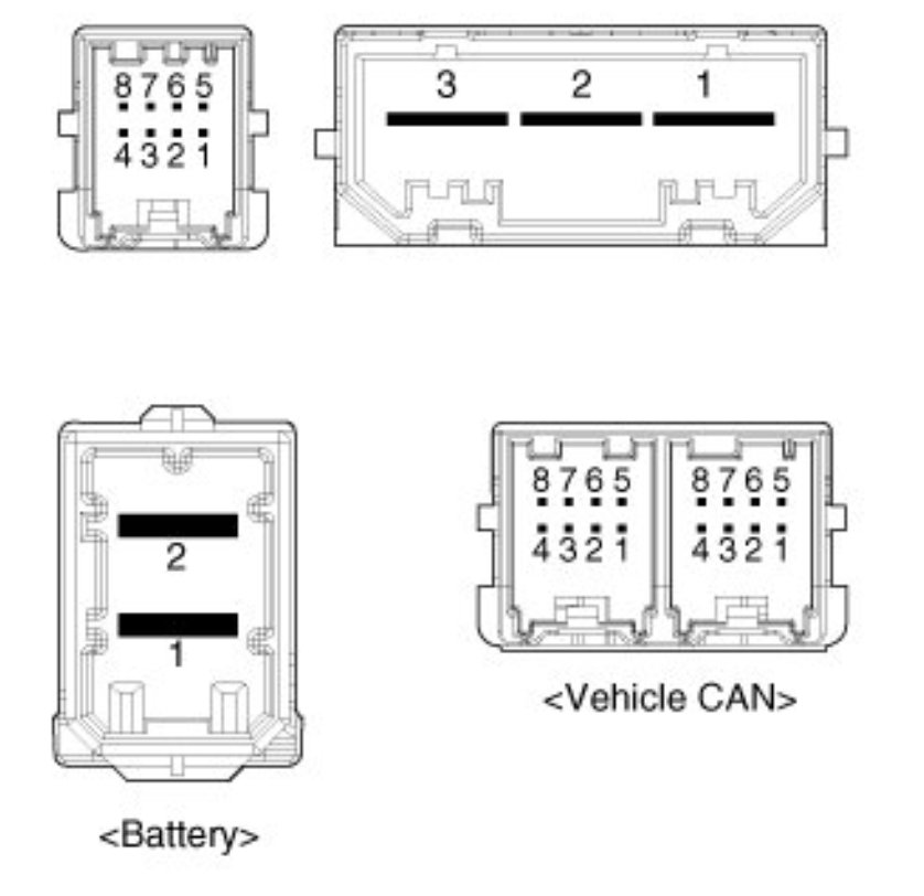

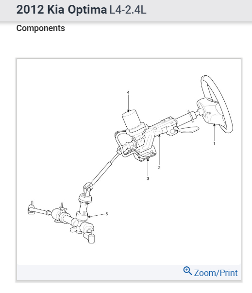

It looks like the power steering motor has gone out or is not getting power. Here is a guide to help you see what is going on with diagrams below to show you how to do the test and how the system works:
Check out the diagrams (below). Please run some tests and get back to us.
