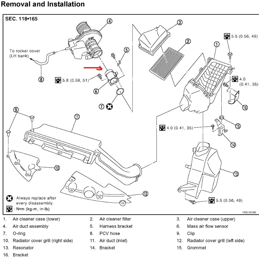

This sounds like a weak fuel pump, or you have a MAF sensor that needs to be replaced, I would service the throttle body as well.
P0300 Random/multiple misfires
P0171 Too lean on Bank 1
Please go over this guide to help you see what is wrong and how to fix it:
https://www.2carpros.com/articles/repair-lean-mixture-codes-p0171-or-p0174-on-some-manufacturers
Here is the location of the MAF sensor and a guide on how to clean the throttle body:
Also, be sure to check the air intake tubes for leaks between the MAF and the throttle body, check out the images (below). Let us know how it goes.

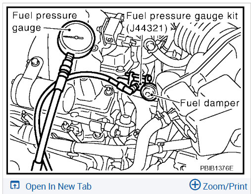

And lastly , any ideas on what I need to check fuel pressure .. seeing there's no Schrader valve on this system , I'm not sure what I need to be able to disconnect the fuel going to the rail , and hook up to my pressure gauge.

Here is how to take the fuel pressure readings:
Fuel pressure at idling .................... Approximately 350 (3.57, 51) kPa (kg/sq.cm, psi)
Check out the images (below). Let us know how it goes.

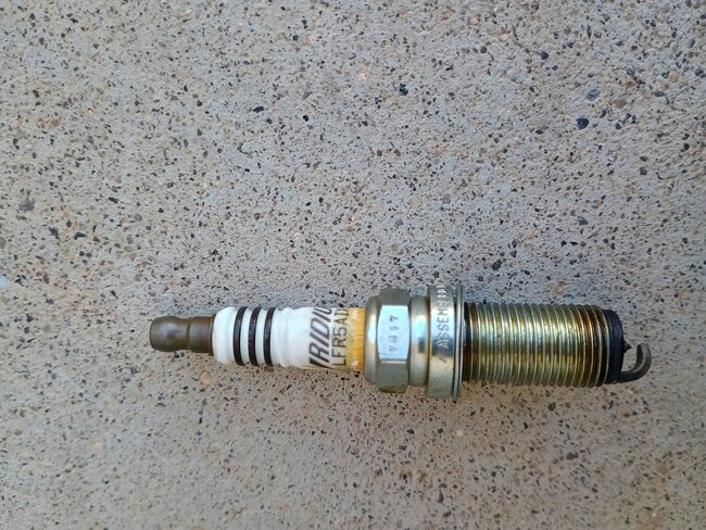

These are the plugs I put in a few hundred miles ago
I removed the three in the front , and two had this burnt ring at the bottom of the porcelain .. what is that telling me ??
Replaced MAF and fuel pump , starts right up and has steady idle , but STFT are still 25 at idle .. numbers get better as RPM increases , and are within spec once around 2500 RPM
Reading live data , I noticed TPS data doesn't seem to be moving as it should , basically stayed between 3 and 6 as I was giving it pedal .. and once it warms up , it was idling down around 560 RPM , which seems low
Have not seen a code come up for the throttle position sensor .. any ideas on the low idle ??
May 14, 2025 at 2:32 AM
  • 55,433 POSTS
So it looks like the STFT is trying to richen the mixture. Can I ask if the engine has an exhaust leak? The spark plug looks normal. Also, this can be because of a vacuum leak as well. Does the TPS voltage move smoothly throughout the range? If not, I would put a new throttle body on it.
