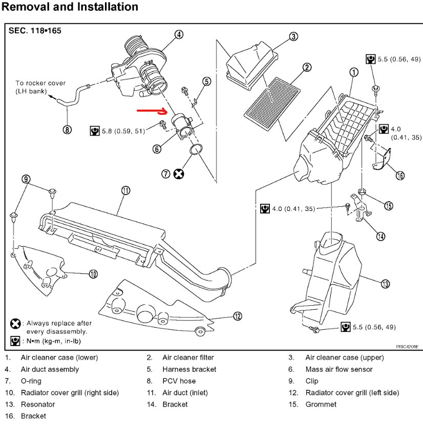

This sounds like a weak fuel pump, or you have a MAF sensor that needs to be replaced, I would service the throttle body as well.
P0300 Random/multiple misfires
P0171 Too lean on Bank 1
Please go over this guide to help you see what is wrong and how to fix it:
https://www.2carpros.com/articles/repair-lean-mixture-codes-p0171-or-p0174-on-some-manufacturers
Here is the location of the MAF sensor and a guide on how to clean the throttle body:
Also, be sure to check the air intake tubes for leaks between the MAF and the throttle body, check out the images (below). Let us know how it goes.

I'm pretty sure there are no vacuum leaks .. my new smoke machine blows pretty good , and I didn't see a wisp of smoke anywhere , except eventually out the front intake by the radiator.
If there was an exhaust leak , what kind of readings would I get from the rear O2 sensor ?? I can't remember , but I'm pretty sure I had a steady reading on the rear O2 sensors , and bouncing pretty good between .2 and .9 volts for the pre-cat sensors , which I believe is acting normally.
And as for the MAF , what should my readings be at idle , 1500 and 2500 rpm ?? and I'm not sure if my scanner reads pounds or metric.
I'd like to verify if the MAF is functioning properly , before replacing.

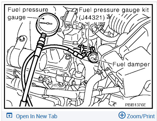

And lastly , any ideas on what I need to check fuel pressure .. seeing there's no Schrader valve on this system , I'm not sure what I need to be able to disconnect the fuel going to the rail , and hook up to my pressure gauge.

Good idea, here are the readings for the MAF sensor:
Idle (-700 RPM) 2 - 5 g/s
1500 RPM 7 - 10 g/s
2500 RPM 12 - 18 g/s
Here is how to take the fuel pressure readings:
Fuel pressure at idling .................... Approximately 350 (3.57, 51) kPa (kg/sq.cm, psi)
Check out the images (below). Let us know how it goes.

The special adapter needed to attach to the fuel rail is difficult to find , trying to figure out a way around that with what I have.

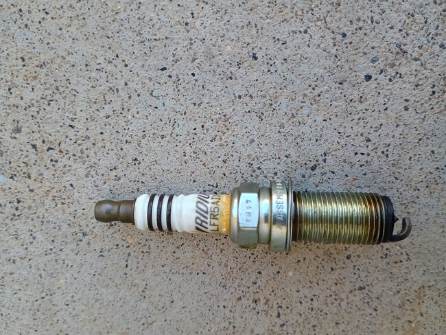

These are the plugs I put in a few hundred miles ago
I removed the three in the front , and two had this burnt ring at the bottom of the porcelain .. what is that telling me ??

So it looks like the STFT is trying to richen the mixture. Can I ask if the engine has an exhaust leak? The spark plug looks normal. Also, this can be because of a vacuum leak as well. Does the TPS voltage move smoothly throughout the range? If not, I would put a new throttle body on it.
