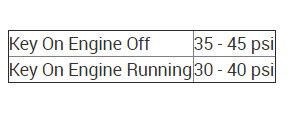

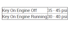

I would suggest you test the fuel pump pressure. You might have a weak or failing pump that is not providing adequate pressure. If you don't have access to a tester most auto parts stores have a tool loaner and can rent you one. Here is tutorial showing what is involved for testing:
The fuel pressure specification for your vehicle is attached below. Hope this helps and keep us updated to go from there. Thanks for using 2CarPros.
