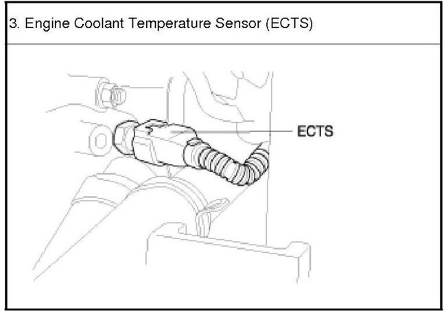

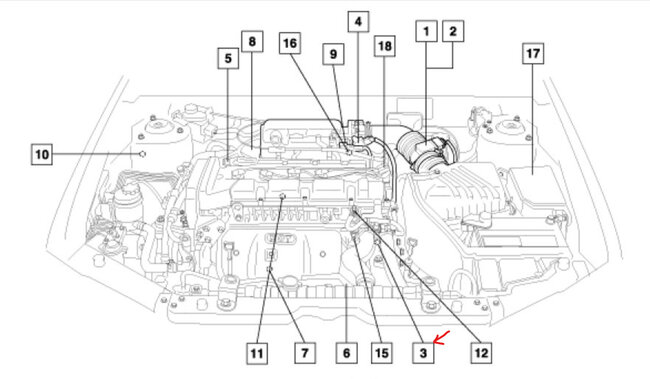

Hard starting can be a few things, but first do you have any trouble codes? Here is a guide to help you check, because it could be the engine coolant sensor.
Here is a guide for hard starting as well:
https://www.2carpros.com/articles/engine-cranks-excessively-before-starting
You may have a weak fuel pump or the vacuum leak or the throttle body needs to be serviced. Here is the location of the engine coolant sensor in case a code is stored for it. Check out the images (below). Please upload pictures or videos in your response of any problems so we can see what to help you with.

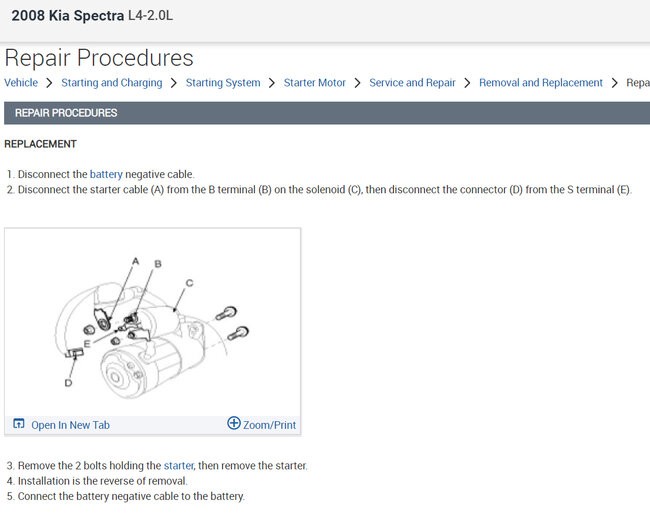

Thanks for the videos, they helped. It sounds like the battery is getting weak, but the starter motor does not sound good either, I would try a new battery first, and I would install a new starter as well.
Here is a generic guide to help you step by step with instructions in the diagrams below to show you how on your car.
Sep 17, 2024 at 2:32 AM

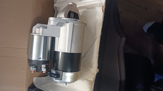

I guess this is the right one. hope so anyway. Will Install it over the weekend.
Sep 27, 2024 at 1:59 AM
  • 55,421 POSTS
Yep, this should fix it, have a nice weekend and let me know please.
