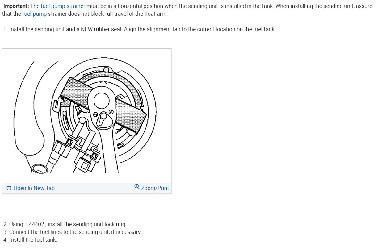

have to crank for 15 to 30 seconds, the engine finally starts.
Oct 13, 2024 at 1:06 AM
  • 55,433 POSTS

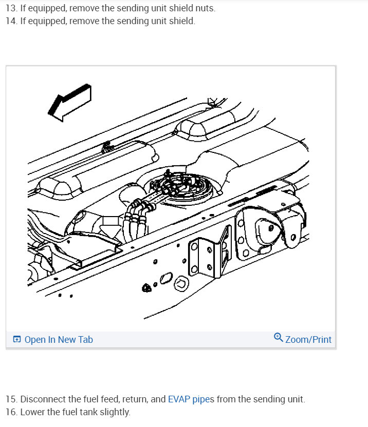

This is a sign of low fuel pressure, or a throttle bore that needs to be cleaned, here is a guide to help us fix it:
https://www.2carpros.com/articles/engine-cranks-excessively-before-starting
I would check the fuel pressure which this guide can help with should be about 48-52 PSI. You can rent a fuel pressure gauge from the auto part store. Here is how the job is done, and I included how to service the throttle body in this video as well.
https://www.youtube.com/watch?v=N2nC4V9DrdQ
And this guide can help with the fuel pressure test:

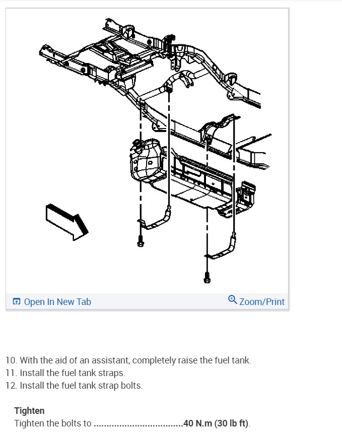

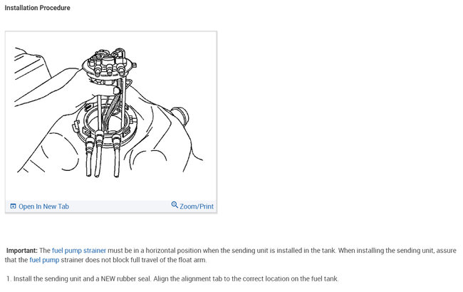

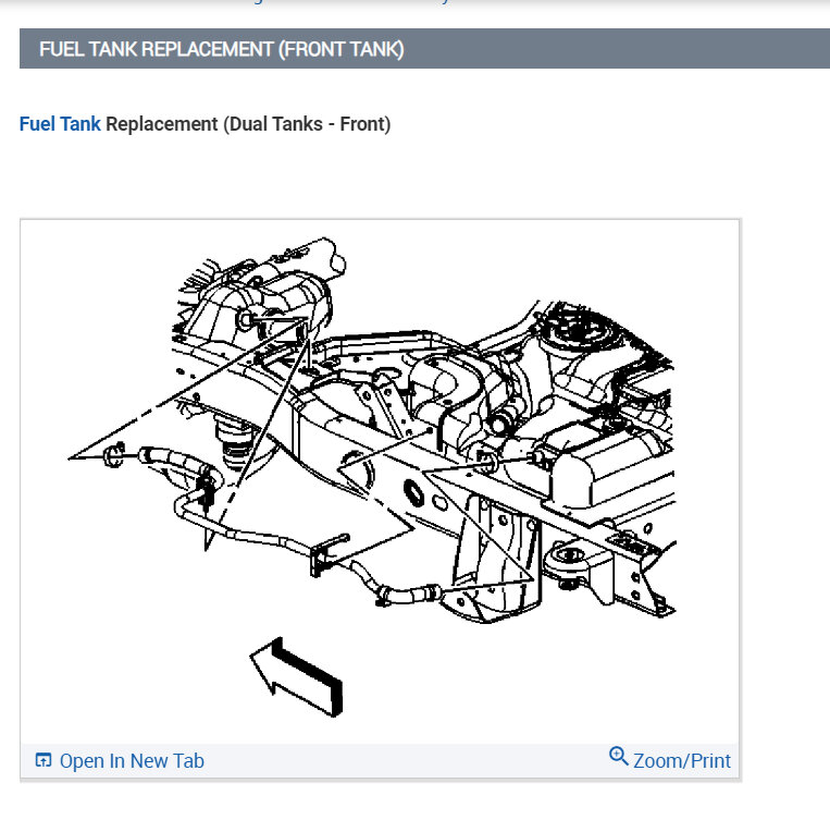

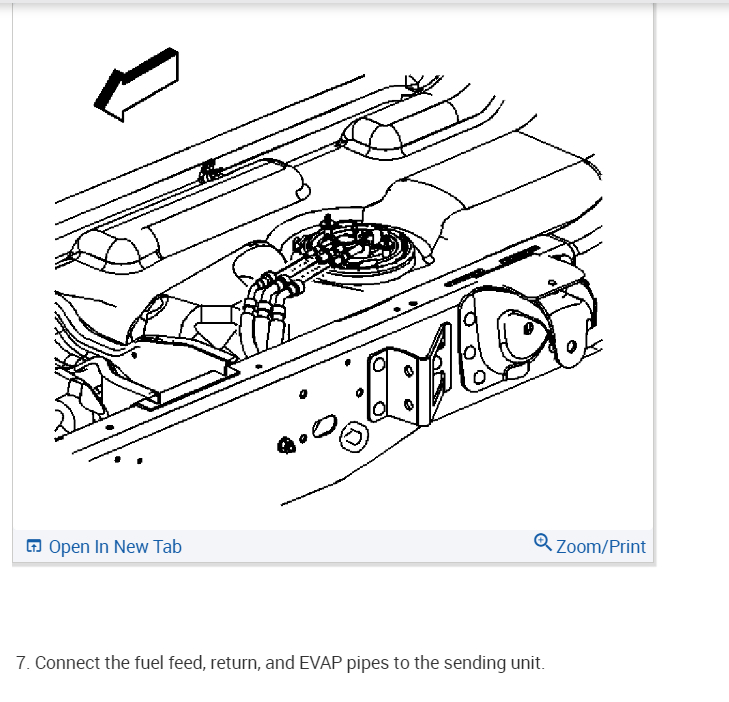

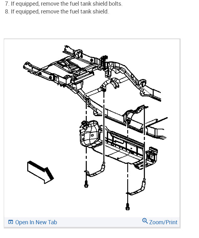

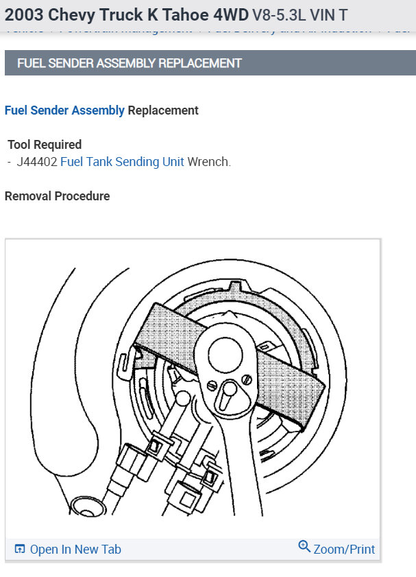

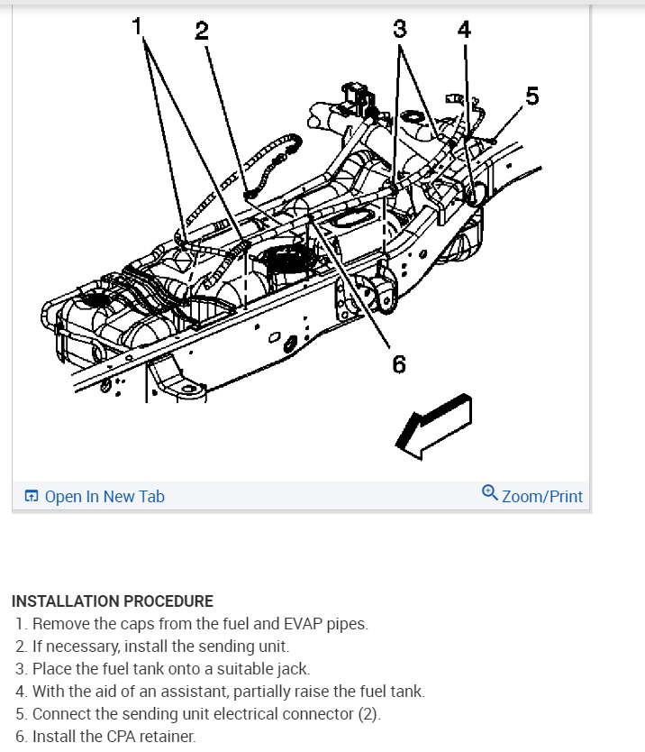

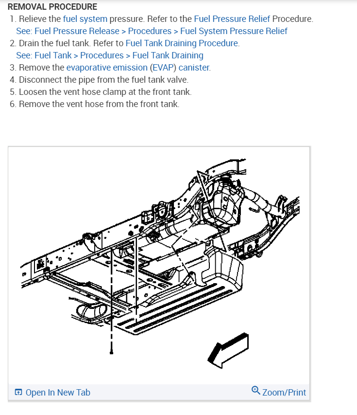

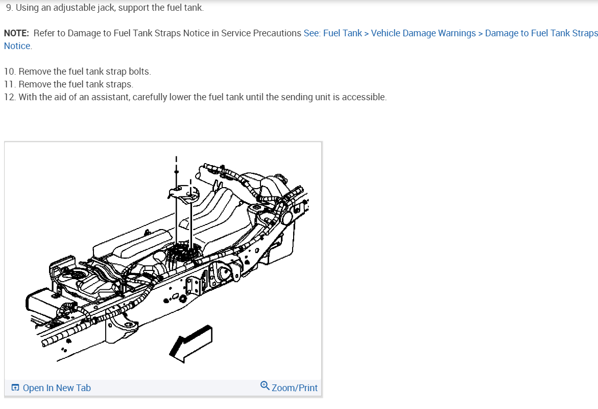

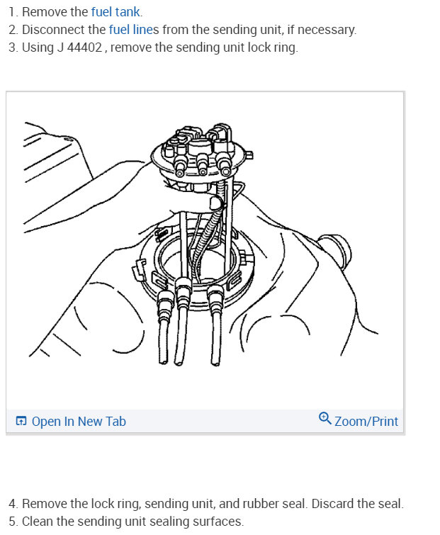

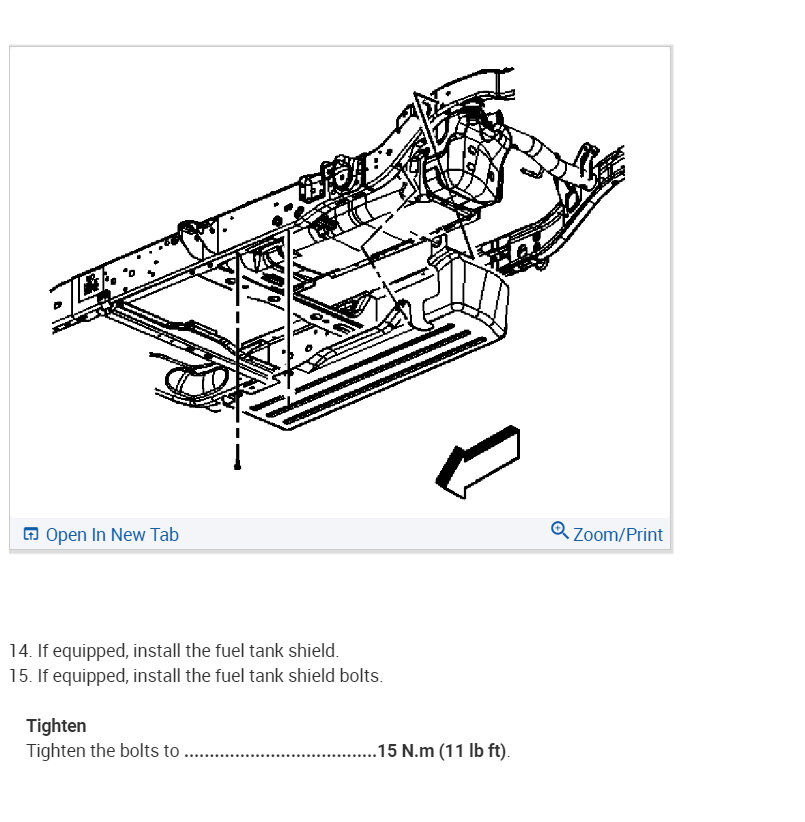

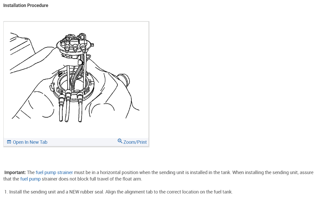

Here is how to change out the fuel pump in case you need it. Check out the images (below). Please let us know what happens.
