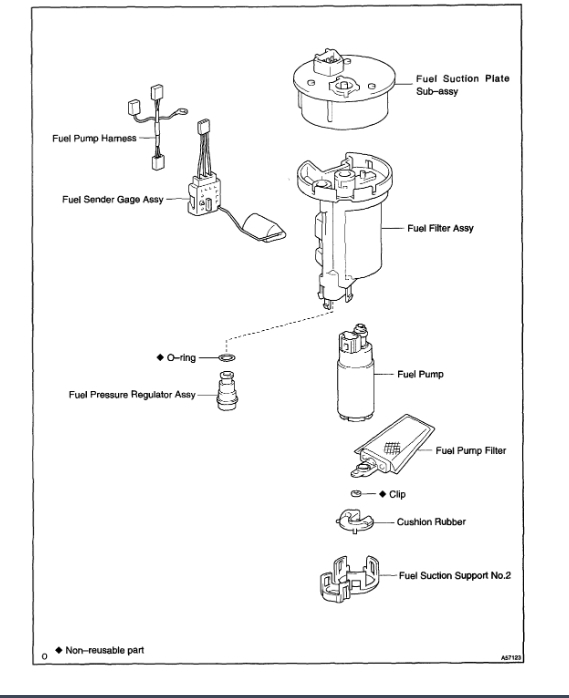

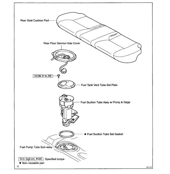

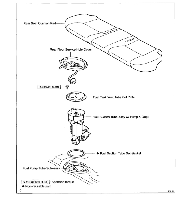

It could be the fuel pump or clogged fuel filter. Check the actual fuel pressure low pressure will cause long crank time. The running pressure should be between 44 - 55 PSI, and after 5 minutes of being shut off, It should not drop below 21 PSI. If the fuel pressure was lower than specified. The fuel pump and the fuel filter should be replaced. I;m attaching repair guides and schematic below. let us know if you need more information.
https://www.2carpros.com/articles/how-to-replace-an-electric-fuel-pump
