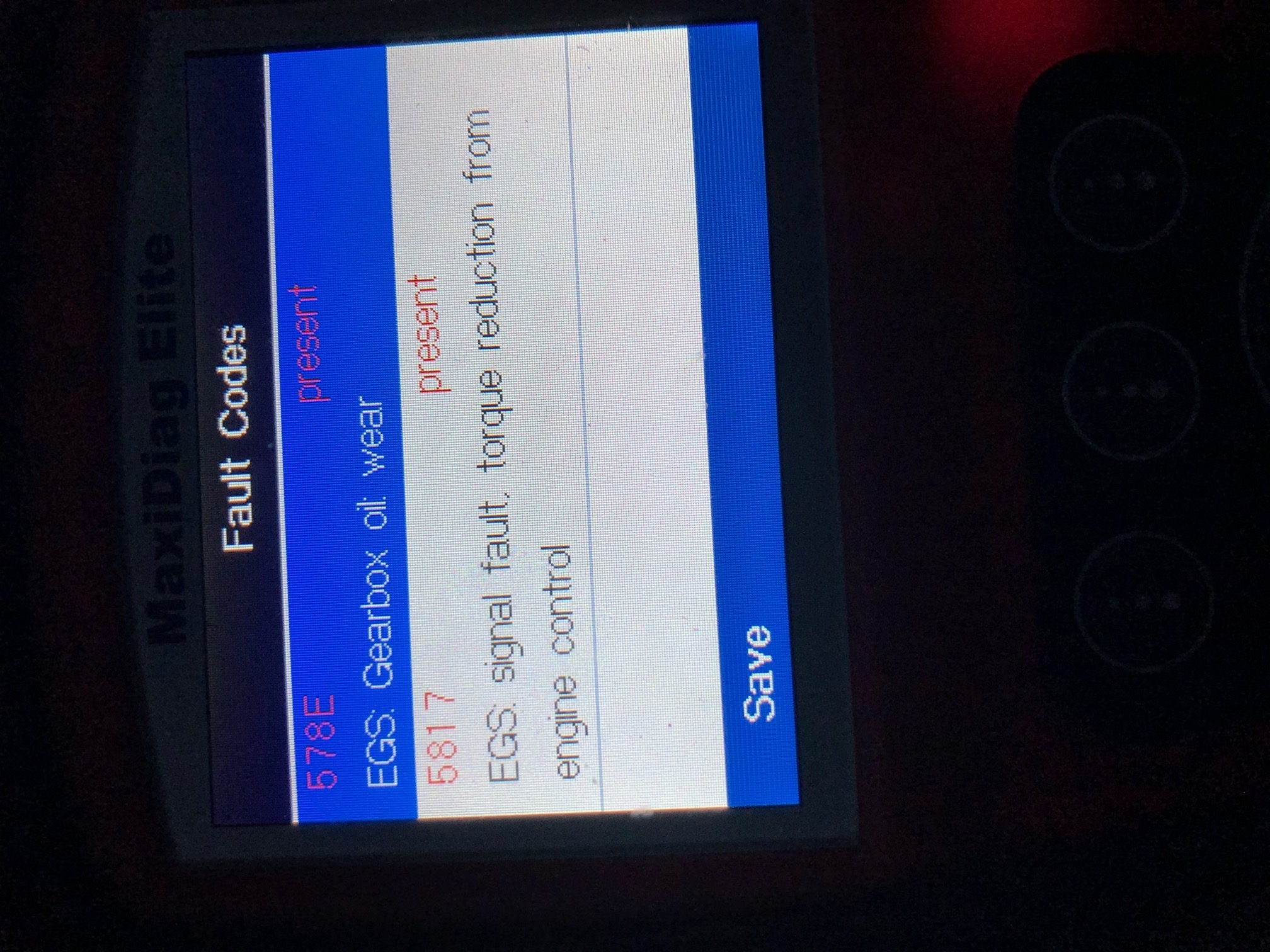

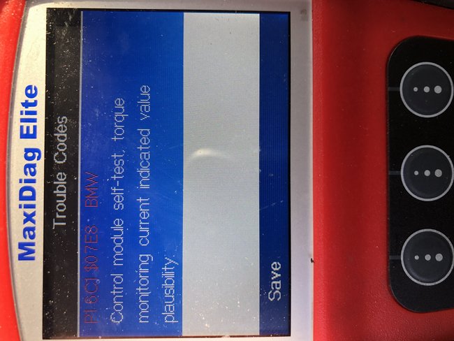

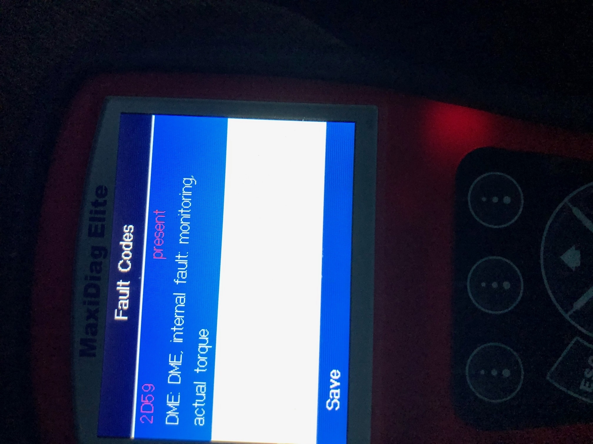

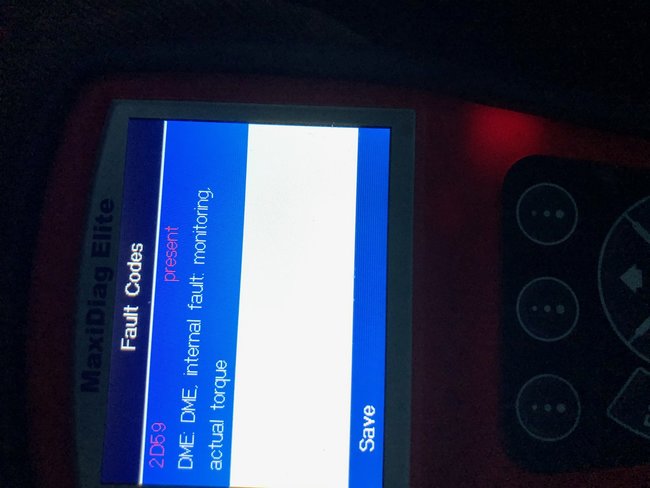

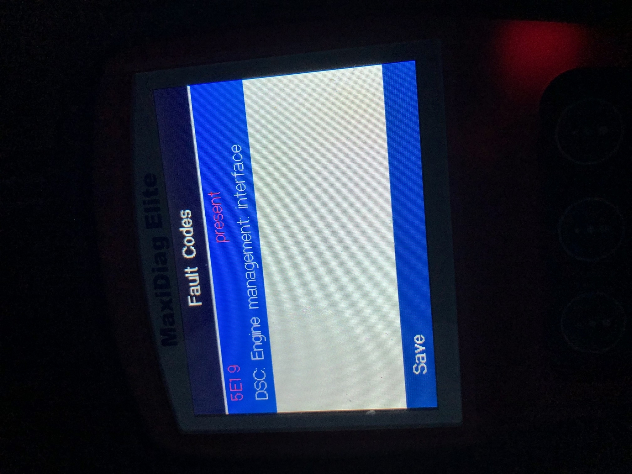

Nothing except this:
Feb 27, 2020 at 11:01 PM
NASER NASER
  • 836 POSTS
finally started after having a jumper, took forever, then was in a limp mode and barely moving with brake and traction lights on, I know these lights come on when battery was drained, until the battery charges, and would not rev up, if you do it will hesitate badly and rpm jumps, got home, turned it off, started right up and all lights gone and revs normally.
Feb 28, 2020 at 8:10 AM
JIS001
  • 3,412 POSTS
The first code you posted is what you need to focus on. The scanner you have is a little more advanced so it gives manufacturers specific codes. If you can get a generic code it makes it a little easier to pinpoint the area to diagnose.
