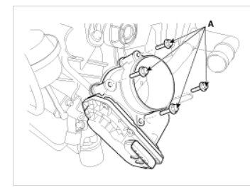

So we got the Kia soul when it was at approx. 90-95k miles and now it’s at 184-185k miles. We’ve done basic maintenance on it and regular oil changes but now it has a hard start problem taking 2-3 maybe 4 seconds to fully turn on after flipping the switch ON, I changed a lot of things on the car like PCV valve, Purge valve, oil control valve (exhaust), camshaft and crank shaft sensor, all 4 spark plugs. It’s still doing the same thing so I’m wondering if it’s the timing chain tensioner (I got a popup from autozone telling me it needs replacing), the fuel pump assembly (under seats in the back) or the high pressure fuel pump GDI. I’m trying to make sure that’s it’s one of those so I don’t replace all or replace one and the problem persists.

Does the engine make a rattling sounds at idle? If so the timing chain and guides can need to be replaced, to me I would start by serving the throttle body. If it is dirty it can cause a hard start condition. Also, are there any codes in the system? Here is a guide to help check.
Here is a guide to help you service the throttle body, also keep an eye out for a leaking vacuum line while you are in there.
Here is how the job is done on your car. I would try this first before, can I ask if the engine has low power? This can be a sign the high pressure fuel pump is going out. Read the guides before you begin. Check out the images (below). Please let us know what happens.

The only code is the camshaft crankshaft code, I don’t know if the throttle body is dirty, how can I check that?

The code is P0016 but as I stated I did change the camshaft and crankshaft… I’m going to check the throttle body if it’s dirty, the throttle body won’t move freely if it’s dirty and it will be visibly dirty right?

Yes, I believe if you go into the guide, it will show what a throttle bore that needs to be serviced looks like. The code P0016 is the clue as well. If you already replaced the sensors and you still have this code it means the VCT is not working due to dirty or low engine oil, a bad oil control valve or VCT unit or the timing chain set including the guides are worn out. Does the engine make a rattling sound at idle? Can you upload a short video of the engine idling so I can hear it?

Here you go, I cleaned the throttle body and did the relearn method for the position sensor. Still does the same thing…

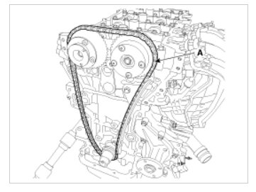

Nice work! yes thanks for the video. Yep, the rattling sound is the timing chain system, this means the timing chain, guides and camshaft actuator need to be replaced much like I suspected in the first post. The only other thing I would try is cleaning the throttle body.

Thank you, so I did clean the throttle body but the actual timing chain has to be replaced? The guides? Camshaft actuator or is it one of these that’ll fix the problem?

Another thing, what are the parts you’re referring to? It’s the whole timing chain? What “guides” and I also cannot find the camshaft actuator?

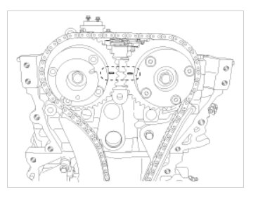

Yes, here are the parts I am talking about, can I ask if servicing the throttle body did any good? You can remove the valve cover to check the timing chain "play" to help confirm the issue. Also, make sure the engine oil is clean and full. The camshaft system depends on this, sorry I didn't mention it sooner. Let me know if you need instructions to do the job. Check out the images (below). Please let us know what happens.

So cleaning the throttle body helped for about 2 full starts then returned to its original shape and performance. Engine oil has just been changed about 3-4 weeks ago but this engine does eat a lot of oil somehow and I’m having to refill 1k miles before the original change date or mileage required (3k). Also, removing the valve cover, will I be able to look right at the timing chain without removing any other parts? I have done so on a jeep compass before so I know how to get in there… camshaft system is what specifically? I changed the camshaft sensor aswell as the crankshaft sensor but in the video that I have sent you can see that oil and smoke spews out of the oil dip stick hole when I took it out. I’ll try to look into the timing chain thing but another thing is I heard some people say that when an engine gets replaced via a recall, Kia will use the old parts for the new engine which can mess up the timing chain aswell, is that a problem?

The valve cover will need to be removed to inspect the timing chain. I would go over everything in this guide before digging into the engine.
