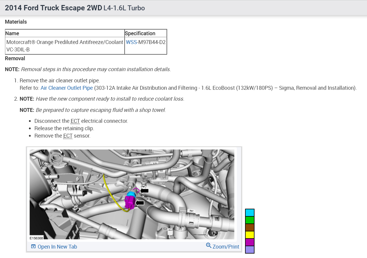

Codes p1026 and p0217, hard shift second to third?
2014 FORD ESCAPE
187,000 MILES • 4 CYL • 2WD • AUTOMATIC
BHAMDOC1973
  • 2,007 POSTS
2nd to 3rd, codes p1026, p0217?
Oct 23, 2022 at 8:05 AM
  • 55,433 POSTS
The p1026 sets when the engine coolant temperature (ECT) and cylinder head temperature 2 (CHT2) sensor readings differ by greater than a calibrated value.
The P0217 code means that the engine is or was overheating.
So, this can be the engine coolant temperature sensor needs to be replaced. here is the location I would replace the sensor and then clear the codes.
